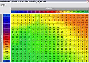

Stock 2005 Evo VIII High Octane Timing Map (96940011 ECU_ID):
l8r)
Attached Thumbnails Knock Issues up High-2005_evo_high_octane_timing_map.jpg

Thanks!! I will compare to my map when I get home and see where i am at!
