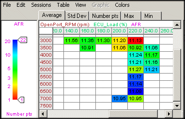

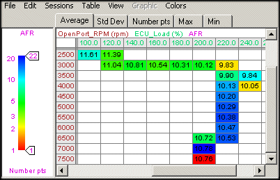

I had similar results to the OP when I disabled the lean spool on my Evo 8. Here are the numbers averaged for two runs before and two runs after
Before
After
Attached Thumbnails Lean Spool Disable, Before/After-afr_f7.gif   Lean Spool Disable, Before/After-afr_f7_nls.gif
