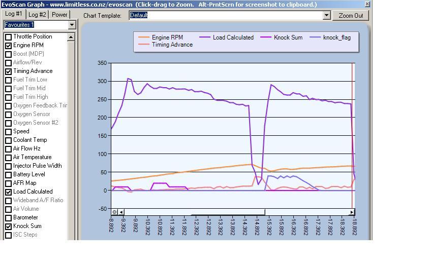

I have a problem, sometimes when I do a pull in a high gear the car feels "jerky", acceleration is not smooth.. like if the power is coming in waves..
So.. I did a log run with evoscan and I see that the timing is going up and down in intervals in a pattern like the one I feel when I drive..
4-10-4-9-5-10-5 ... etc..
I attach the log, it's from 3rd and 4th gear, especially in 4th you can see the ignition going up and down.. What could cause this? Knocksum is 0 in 4th gear.. But knock_flag is giving some data, don't know if this flag could cause this? You can also see a little bit of this in 3rd gear at about 5500 rpm but with 0 knocksum and knock_flag...
Please help!

I can't see squat on that graph. Post a better graph or post the log data.

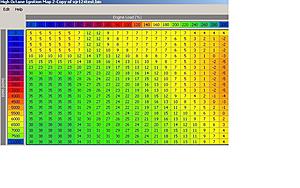

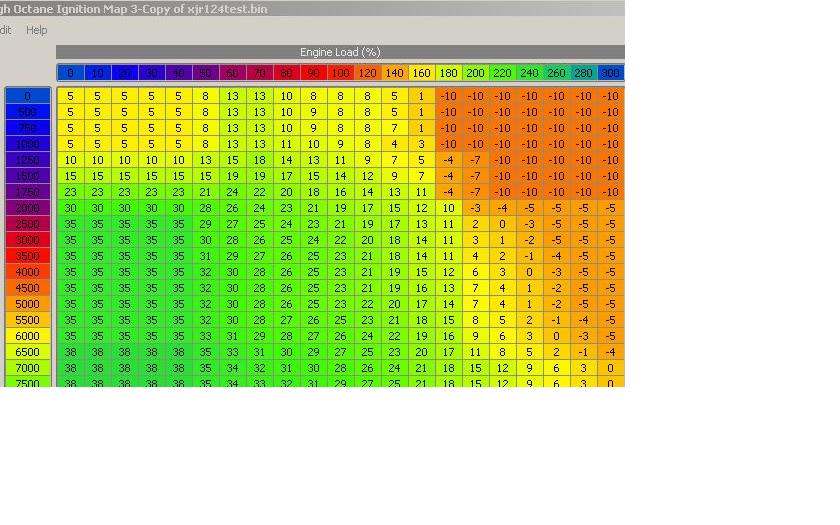

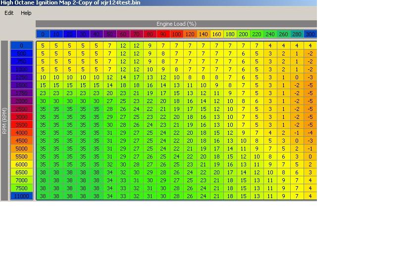

I have changed all three ignition maps.. to have a relation between them that is like stock.. #1 is highest, just over #2 and #3 is a lot lower..
Here are my ignition maps.
https://www.evolutionm.net/forums/at...8&d=1177274493
https://www.evolutionm.net/forums/at...9&d=1177274502
I also attach ignmap 3.

It's staying in your first timing map, the problem is the timing values you have in there aren't smooth. The boost spikes, hits a high load where the timing values are negative, then as the car gets moving the load decreases and the timing comes back up but the values in adjacent cells are as far as 4* from each other so the ecu is bouncing back and forth between load columns which forces the car to make radical timing changes.
I bet the car is very slow for two reasons:
1) the overall timing is very low
2) the timing is shifting from low to high and back
I could get you fixed up pretty quickly and explain where and why I'm making changes so that you can learn during the process. Let me know if you're interested (see sig)

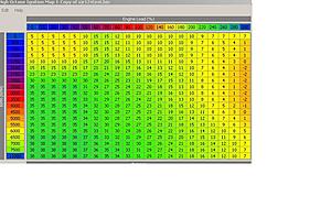

Do you mean that it is shifting between the timing maps? Or do you mean that it is using ignition map nr 1? How do you see that?
I am attaching the new ign maps I am flashing to the ECU now..
Attached Thumbnails Ignition advance going up and down!-ign1_new.jpg   Ignition advance going up and down!-ign2_new.jpg   Ignition advance going up and down!-ign3_new.jpg

it's staying in the first map, watch the octane numbers stay 100
