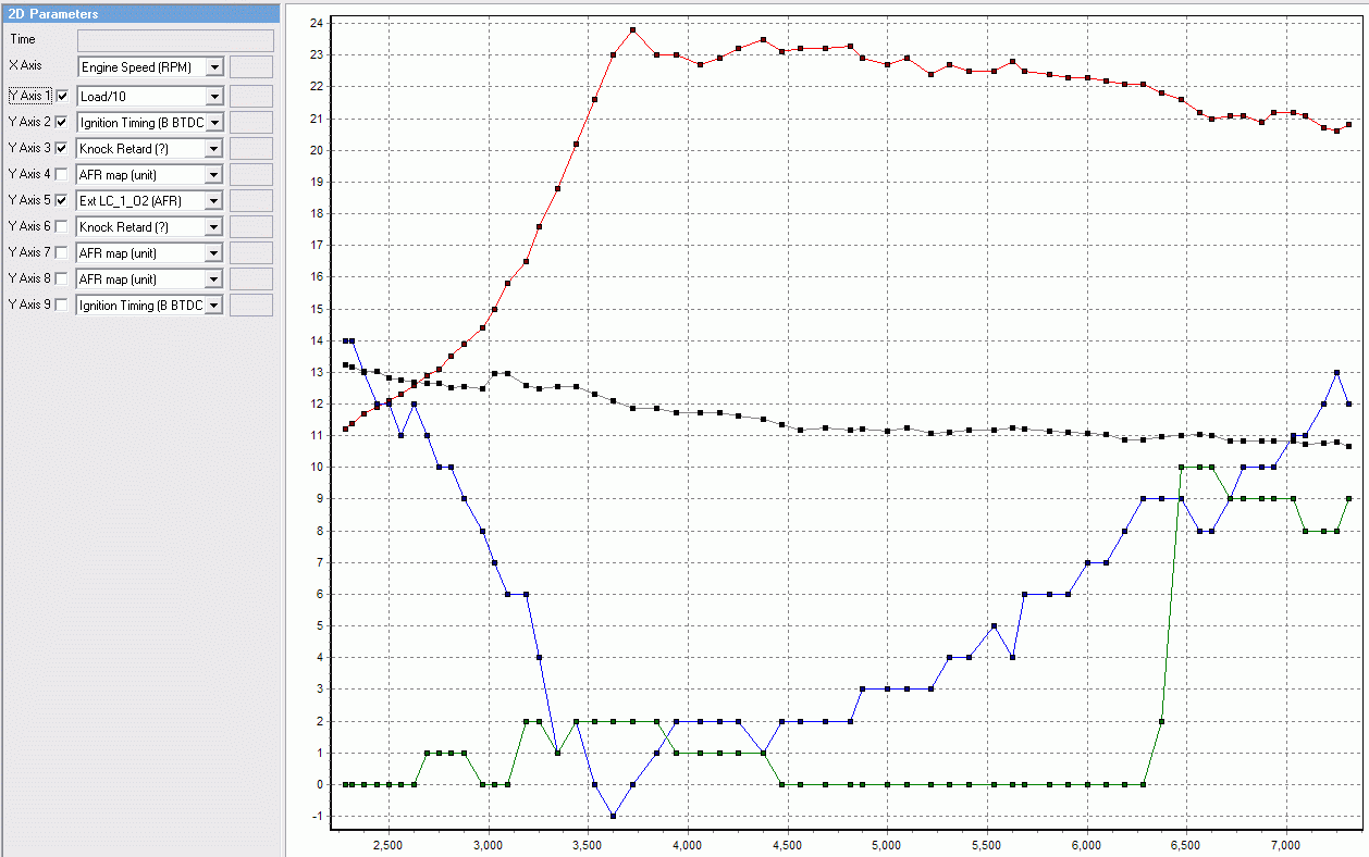

My latest run:

I really appreciate the help guys. I love learning about this stuff. Is my timing in the 6000RPM range too high. It was showing no knock from 4500 to 6500... then bang, 10 counts.

still way too lean during spoolup and look at 3500... still knocking even though your timing is retarded. I bet the car is very slow like that.
You really need to focus on fixing the low RPM range before you move on to higher RPM

let me give you a few milestones to go after:
2500 12.0:1
2800 11.5:1
3000 11.0:1 and hold that AFR to redline
this is very basic and conservative but it should get you to where you can run a little more timing. then you can fine tune it from there.
