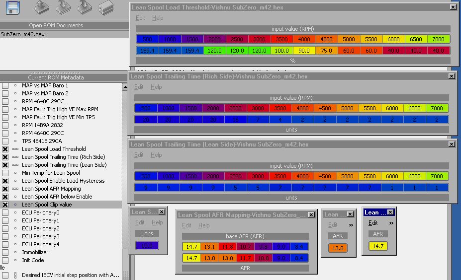

The lean spool program is fairly complicated. It does have setting that kick into action even before reaching the "lean spool start rpm". When the load crosses a threshold value at lower rpms, it does appear that the lean spool program can change the AFR. Did you verify that the same thing does not happen when the lean spool rpm is set to 7000 rpm?

intersting pic. is this the stock setting ?
looks like it only leans out after certain threshold and APR values only.
share more info about memory location for other maps please.
