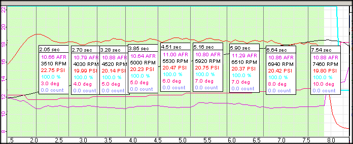

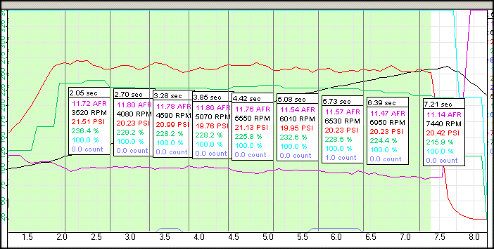

So people here can get a good idea of what is going on, I am including these two charts. It is a better visual than the nubmers I posted earlier.
AFR when I first flashed the car. The AFR is nice and steady and goes from 11.7 to 11 by redline/cuttoff.
Now here is the chart after driving the car. Notice how the AFR has become richer. I know that the boost is slightly higher @ peak. But I have other charts with the same boost in two logs one with a lean AFR and one with rich AFR. Notice how the AFR is rich from peak to 6000 rpm and then it recovers to what it was in the chart above.
Attached Thumbnails Help with Funky AFR-afr_ok.gif   Help with Funky AFR-afr_funky.gif

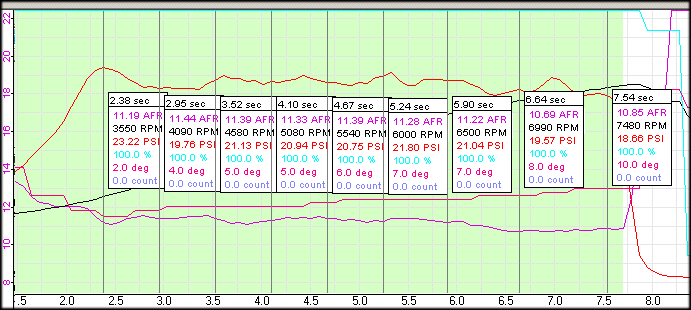

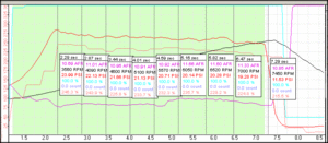

As I said in the post, I have charts with similar boost that show the same funky afr behavior. Here are two of them with the timing included. This is the SAME flash. One log was BEFORE I drove the car to work and the second log is AFTER I came back from work. These logs have the Lean Spool disabled.
Before the drive with good AFRin the 11.4-11 range.
After the drive to/from work. AFR drops below 11 in the 3500-6000 rpm and then jumps back where it should be in the 6000+ rpm.
Attached Thumbnails Help with Funky AFR-afr_ok2.gif   Help with Funky AFR-afr_funky2.gif
