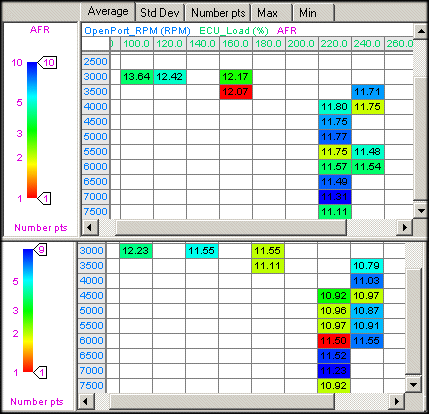

I am at a loss as to why this is going on. Here is what happens:
I flash the car on Sunday and do some logs the AFR is as it should be. You can see it in the chart on top in the image below. I am very satisfied with the tune. Monday morning on my way to work, I do a log with the SAME flash but the AFR changes and the AFR is about 1 full point richer in some areas. you can see this in the image in the bottom in the image below.
I thought that is was Lean Spool related. So, this morning I flash the car with a non-lean spool flash and do a long and the AFR is where it should be. I drive to work park the car and then on the way back from work do another log and the AFRs are RICH again.
When I get home I flash the car back to the flash that I used on Sunday and do some logs and the AFR is back to normal. If the trend holds, then the AFR tomorrow morning will be rich again.

Do you still have the ebay filter on? Intake temps the same on both logs? Looks like up top once you are moving and getting more airflow both logs are almost the same.

are you runing the same boost with both flashes? when there is more boost your afrs richen
i also see that the 2nd log your on a higher load colum more time then the first log
I am now running a drop-in K&N. The intake temps did not change a lot.
When I first flash the ECU and do a log the AFR is where it should be. The very next day with the same flash, the AFR goes rich from peak boost to about 6000 rpm. As you observed, after 6000 rpm the AFR goes back close to where it should be.

The boost, timing and AFR is the same. The tables are logged on the SAME flash, but I get a richer AFR in one than in the other. Both the 220 and 240 load colums have the same AFR target, so the load is not an issue.
Why does my AFR gets messed up when I park the car and let it rest for a while? Why do I get good AFR on the same flash one time and a rich AFR the next time????
