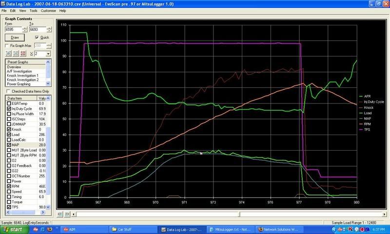

I finished the break in for my new clutch yesterday. I was messing around last night and the car was fine. AFR by the ZT-2 LCD was spot on with what I had tuned for before the clutch went out.

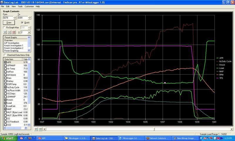

Today, on the way home from work I wanted to get some logs before I started messing around some more. I dropped it into 4th @ 4k rpm and went WOT. Immediately the car started bucking like I had a boost leak. I pulled off into a parking lot and checked everything over, nothing was loose or blown off. Got back on the highway and tried again in 4th @ 2krpm. This time, everything was OK until 6k rpm. AFR went way rich and the car noticeably lost power. Reviewing the logs, 2 byte load went on a trip. I think maybe the used GMMAF I have has taken a crap on me from all the humidity today. In the logs below, AFR is scaled to x5 for better resolution. In the logs from today, I believe AFR was below the ZT-2 rich threshold.
Log from last month, 2byte load tracks with boost:
4th @ 4krpm:
4th @ 2krpm and up, 2 byte load no longer tracks with boost :
I want to log 2byte airflow to see what the MAFT Pro is actually outputting to the ECU, can someone point me in the right direction for adding 2 byte airflow?

Thanks dude. I set it up, just haven't reflashed yet. I pulled the MAF and sprayed some cleaner on it, seemed to help a bit. AFR was at 10.8:1 from 6k to redline, but I wasn't logging to see what load was doing.

Relogged tonight after the 2byte airflow mod. Cleaning the MAF seemed to help, but I think the MAF may be on its way out. AFR curve was back to normal, but 1 full point richer than I had tuned it for previously. Here's the graph from today:
IF someone with the 2 byte airflow could post up what their airflow trace looks like, I'd appreciate it. I want to compare "smoothness" between the GMMAF and a stock MAF.
