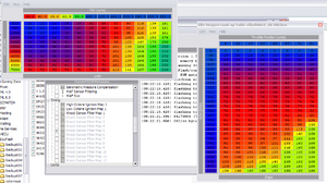

Old Aug 30, 2007 | 06:29 AM
Jorge T's Avatar
Posts: 1,494
From: Houston, TX
1.31 seems to work OK except for the greyed out entries which still display map, the order of tables and the idle stepper RPM(can't remember if it was like this since it displays the same with several ROM ids ).
