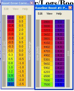

Here is a directory with 3 logs (these logs had the TBEC of the attached map)
LOGS WITH TBEC ON
Here are some logs with TBEC turned off (zeroed out)
LOGS WITH TBEC OFF
Do you think using a pill would help smooth things out?
