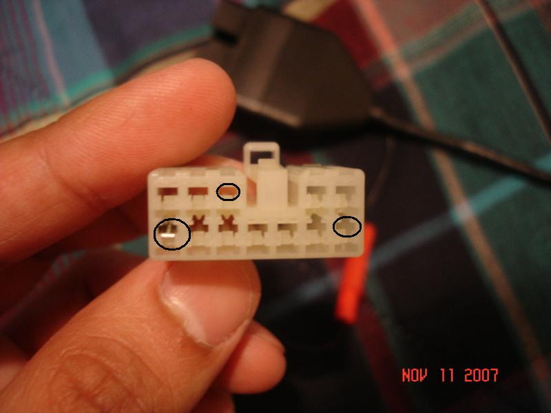

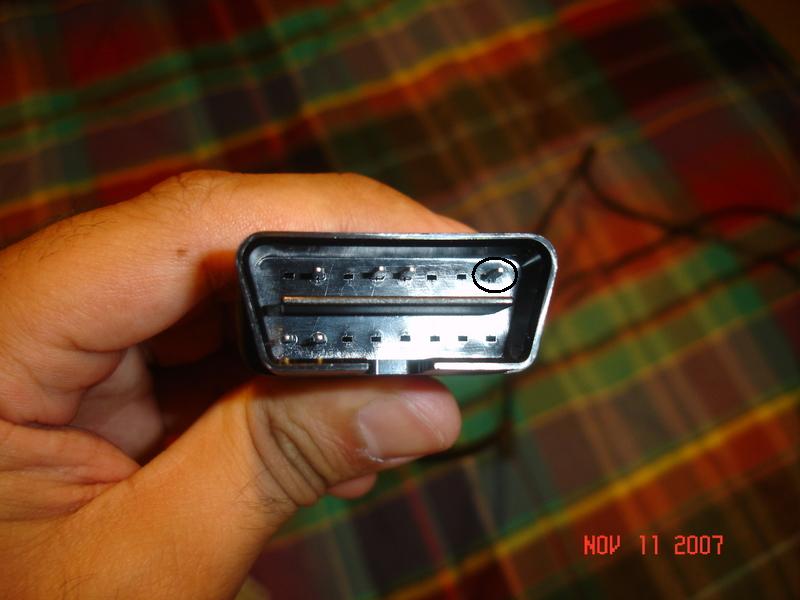

these are pics of mine... it doesnt want to work on my evo IX,
when I connect it I get the following error. I am thinking there is posibly something wrong with my cable.
"interface close"
"interface close"

it's close
your black has an extra pin circled and the white is missing some circled
Attached Thumbnails What does your tractrix cable look like?-025.jpg   What does your tractrix cable look like?-028.jpg

do you think i can just add the two pins my white cable is missing - do you know if all three connect to the same black wire?

yes they all connect to the same wire. can you just add 2 pins? I don't know.

why dont you look into the white init socket in your car baside the obdII socket,
see where the init pin is and remove the pin from the plug on the tatrix cable and swap it over. simple
There should be only one pin in the socket in the car, just make sure the white tatrix connector pin mates up to that,
you will need a very small screwdriver to remove the pin from the tatrix white init connector so you can swap it over.

The white connector only needs that one pin to flash. How do I know? I only used that white pin on a car that had the white connector on the car side cut off. Also the white car side connector only has one pin out.
The black side, the top right pin needs to be swapped to the bottom right.

should I just open the cable base (black part) and relocate the pin?
I noticed that the plug on my car (evo IX) has unputs for the pins already on the cable but is missing the one you mentioned on the bottom right....

no just relocate the pin in the white connector to the same place it is on the white connector in your car dont open the tatrix black cable
Old Nov 12, 2007 | 11:23 AM
BarryC's Avatar
Joined: Aug 2006
Posts: 264
From: Ireland
actually from looking at the wiring diagrams it shows the only pin in the white connector in the car is in the same place as the cable in your white connector, position 26 on the white connector

im so mad, i feel ripped off....
yes my white connector is right. but I think i am missing a pin on the back tactrix connector... I wonder if that is why my cable wont read the ECu.
