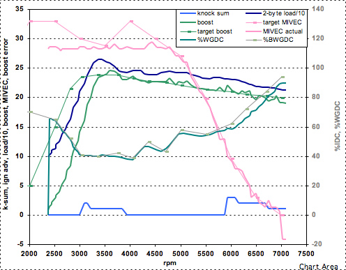

I'm pretty sure that I've found the RAM variable that contains the actual MIVEC position. For the USDM Evo IX, it looks to be 0xFFFF7650. Below is a plot of actual MIVEC vs the MIVEC trace through the my current MIVEC map. Actual MIVEC is not reaching 30. The max value is hovering around 28.2 - 28.6.
I've been thinking about the MIVEC CEL code that people have mentioned. Even with the 33 deg request in my MIVEC table, I've yet to see the MIVEC CEL in the year or so since I started tinkering with this tune. And the ROM code definitely has safeguards that clip requests greater than 28.8 deg back down to 28.8 deg. So, I'd be somewhat surprised if anyone is getting a MIVEC CEL from running values greater than 28.8 deg in their MIVEC table. If they are, I'd like to see their ROM.
On another note, the 28.8 deg limit built into the software is not "hardwired" into the code. It can be changed. If someone could measure a MIVEC gear assembly to see if more than 28.8 deg are available, then this value could be bumped up.

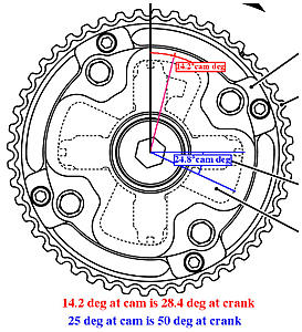

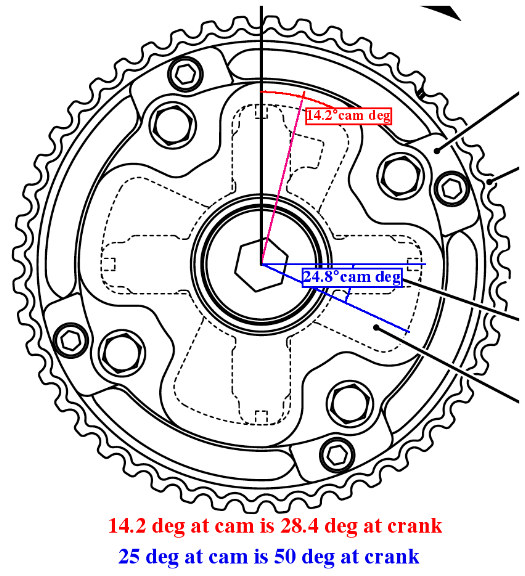

Now I've pretty much convinced myself that approx 28-29 deg is the max advance. I grabbed a drawing of the MIVEC assembly from the FSM and measured the amount of rotation possible. Assuming the drawing proportions are reasonably correct, then it looks like there is room for up to 50 deg of advance. However, there is a nub on one of the MIVEC arms that limits the MIVEC advance to 28.8 deg. Seems like that nub would have to sawed off get more than 28.8 deg.

Is the 4G63 an interference motor? If so, how may degrees of cam advance until the piston and the valve go boom? If they use the same MIVEC assembly for other cars, the length of that stud is probably used to set the safe limit for each car.
that's what I was thinking... I think that 30 degrees is a mechanical limit, not a software one.

I agree that the mechanical limit on advance is likely to protect the valves from running into each other or into the piston. There must be some safety cushion though because Cosi and GSC cams must have either longer duration or more lift or both. I imagine that there must be at least a few cam degrees of safety cushion.

What if you only shave off like 5-6mm to get like 35 or 40 degrees of timing? Or get one made?
