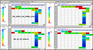

Here is what I have. 4 back to back logs of two Evos with the mods listed and the boost recorded. Very interesting that the car with the higher boost had less airflow due to the restrictive cat. These are average numbers. Peak numbers are slightly higher.
