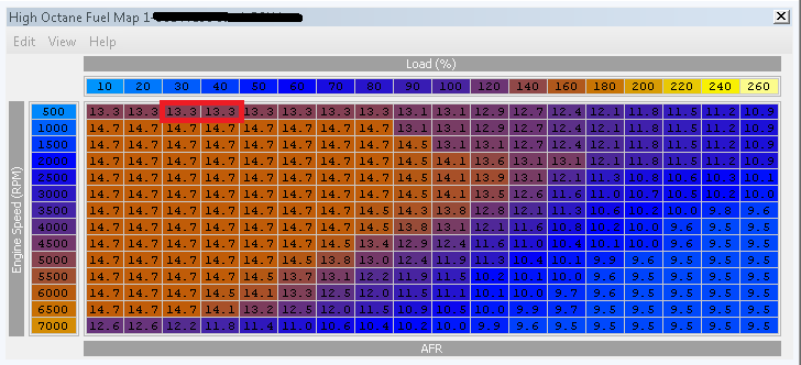

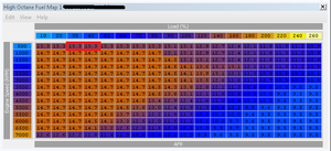

Take a look at these.
Totally original High Octane Fuel Map, and a MapTracer showing "Count".
This is taken on a typical traffic congested scenario, lots of stop and go, no chance to rev up.
You'll notice that 500rpm, load cell 30 & 40 are clocking up 5x that of cruising cell at 2000rpm load cell 70-80.
What make it worst is, the fuel map have 13.3 right at 500rpm across the entire < 80 load. There must be a reason why Mitsubishi did this...
But right off my head, all other cells in low load area are 14+, why is it that only the 500rpm cell assigned 13.3 ? There's a huge potential to lean thing out here
Attached Thumbnails economy tuning-maptracer.png   economy tuning-fuel-map.png
