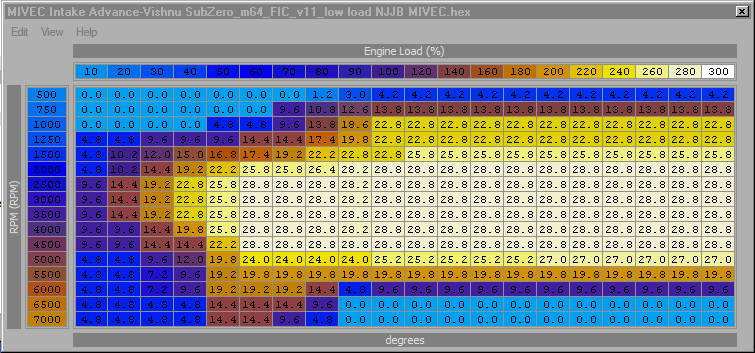

I'm now messing the MIVEC maps a bit. I tried three different maps today with different values in the lower load cells (load of 100 and below). The first map was essentially the stock map, the 2nd, which has slightly more aggressive advance, was essentially the JDM RS map, and the third, which has yet more advance, was something very close to what nj1266 posted in his "how to tune an Evo" thread. It was very hard to tell the difference between the "moderate" map and the stock map. The most aggressive map gave mild improvements in torque over stock in the 2000 - 2500 rpm range, but it was very mild. I had to do back-to-back runs on the same piece of road to be sure. The two maps are posted below.
That will very likely be it for my MIVEC adjustments for economy tuning. I'm switching over to messing with timing one last time to see if there are any more improvements to be made with yet more timing.
First map: Essentially stock for loads of less than 90
Third map: Similar to nj1266's map for loads of less than 100
Attached Thumbnails economy tuning-mivec-m64v9.gif   economy tuning-mivec-m64v11.gif

I find advancing MIVEC at idle gives better drive-ability off the line.
ie I dont need to rev the car so much to take of in normal traffic.
Old Jul 30, 2008 | 09:04 PM
  #269
nj1266's Avatar
Posts: 3,254
Likes: 13
From: USA
^^^ What are your mivec numbers at idle?
