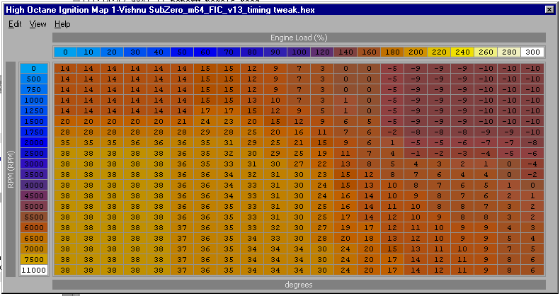

I'm up to 21 mpg. Still at 14.7 afr in closed-loop (I'll start running 15.3 next week). I think the extra 1 mpg is just from bumping the tire pressure up from 33f/30r to 36f/33r. I have made a few changes to the timing maps in the last few days. I've added more timing in selected spots and then had to remove a few degrees of timing in the 2500-3000 rpm / 70-80 load cells. I was getting very consistent knock of around 1-2 counts (but saw a 9 count in one log) when traversing these cells. Part of it was that I had modified the EGR advance map to toss in 1 degree of timing in these cells (versus 0 deg in the stock EGR advance map), and I think that is what was triggering the knock. I removed that 1 deg of advance, and I still pulled 1 deg out of the high oct ign map as well in that range. If there's no further knock, I'll try adding back the 1 deg in the ign map. My overall experience is that the EGR advance map can/should be left alone for the most part, but for the main timing map, there's no problem at all with adding 3 deg of timing in all of the cruise cells. I've got as much as 6 deg more timing in some cells. Here are my current timing maps:
Hi Oct Timing Map:
Hi Oct EGR Advance Map:
Attached Thumbnails economy tuning-m64v13-ign-map.gif   economy tuning-m64v13-egr-advance.gif
Old Aug 4, 2008 | 07:37 AM
  #283
Chabada15's Avatar
Joined: Jul 2007
Posts: 638
From: Long Island, NY
im using the open loop method, but my timing map has 38* in the 50 and 60 load cells around approximatly where yours is 36* and 34*, but im running less in the 0 and 10 load cells i think around 36*, and im still getting a no load rev knock, like if im sitting and i rev the engine hard i get 1 count consistently...havnt had a chance to log the load, i just noticed it quickly when i flashed it for the leaner idle, im finding my idle is fluctuating at random, its set to idle at 15.9 i usually see around 16.0-16.1 but randomly its been hitting 17.0, egts dont even move so i dont believe it to be dangerous if i tap the gas it goes back to normal...my delemma so far, like i said i have no dam time to get this straigtened out...i will attest to better fuel economy tho
Old Aug 4, 2008 | 08:20 AM
  #284
mrfred's Avatar
iTrader: (50)
Posts: 9,675
Likes: 132
My understanding is that leaner mixtures will burn even slower than at 14.7:1, so more timing is possible.
Old Aug 4, 2008 | 09:14 AM
  #285
Chabada15's Avatar
Joined: Jul 2007
Posts: 638
wow...thats good to know...i was going to start implimenting 40*+ of timing in the lower load lower rpm sections of cruise and see where the knock limit is...i have up until now been very conservative.
