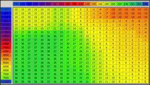

Here is the timing map. The mivec map is the same one I posted in the mivec thread and in the tune your Evo thread. The 26.2 was with 70/30 freeway/street driving before I disabled closed loop. I am hoping it should be around 28 on the next tank.

How much timing advance at cruise is too much? At such low loads, knock will be a non-issue so it's possible to over-advance and not know it...

ok, so you're basically at 28.8 deg of MIVEC advance in the cruise cells (50-100 load and 2000-4000 rpm). That's quite a bit more MIVEC advance than what I run. I may try upping the values in my tune.
