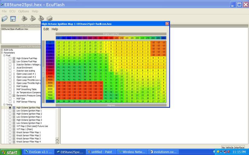

here is my e85timing map for those interested sense were sharing them here
Do you see any knock during cruise, say at 2000-3000 rpm, loads 50-100?

Posts: 100
From: rancho cucamonga
i dont see any know at all during cruise. the only ti,e i see knock is the 1 count i get in the middle of these hot california days when im at 100% throttle 3000-4000prm after spool up im not sure y i get this but its never consistant. and besides that im good.

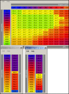

I got my ECU closed loop under control. Now, I cruise in open loop at ~15.6:1 AFR. I also advanced the timing in the cruise load cells. My timing is now ~39*
I tested the set-up at low speeds on surface streets and at cruising between 60 and 70 mph and all is kosher.
Here are the AFR and Timing graphs. The tables are for 40 minutes of cruising to work:
And here are the rom tables:
The only thing that I could not get to work, is get the car to idle at 15.xx:1. I tried setting the tables below the load and throttle % that I logged at idle and it did not work.
But the most important thing is that at cruise I am hitting 15.5-15.7:1 and the timing is advanced by 3* from stock in the cruise cells.
I have tested the set-up last night and today on my way to and from work.
One interesting note, the trims LTFT (mid and lo) and STFT stopped working when I did this. They did not change at all. So I flashed the car back to the stock load/throttle tables and the trims started moving again.
I have a full gas tank and will test the impact on fuel economy. I got 26.2 mpg on my last tank w/o any boost and not revving past 3000 rpm.

NJ1266
I never could figure out what the two openloop load maps do. Set them both to zero, top to bottom, doesn't make any difference.
As to why you're not getting the afr at idle, strange, that has worked for me at just about any map load setting. As a last resort try leaning out your fuel map a lot more from 0 to 30, up to around 1500 rpm.
One little fly in the ointment, there was an intermittent afr swing to rich during cruise.
I think I killed it by lowering my accel enrichment values. Might be something there for your idle too.
The dead fuel trims are a bonus.
