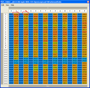

could you post your 2byte load 96530006 xml file?what must I do for to set ecuflash?
Old Feb 22, 2008 | 12:53 PM
evo828's Avatar
Posts: 195
From: Slovakia
Attached is the zipped xml for 96530006 - remove all the other files beginning with 96530006 from the evo folder in Ecuflash.
I am attaching also a screenshot of what you need to have in the MUT table after opening and editing your ROM.
File Type: zip
