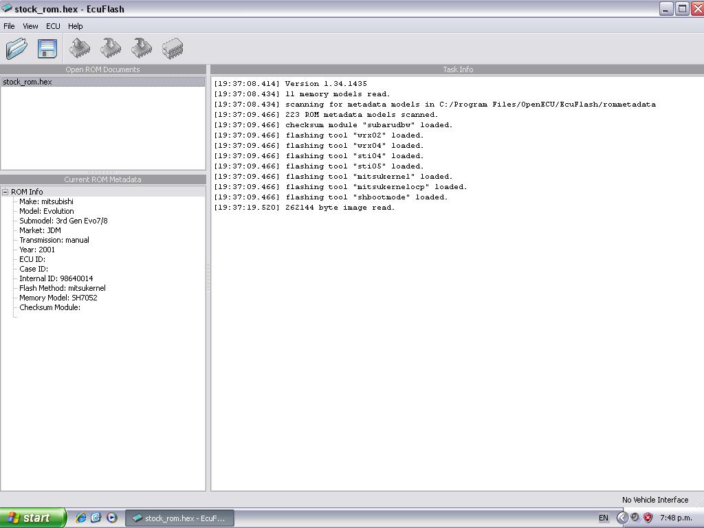

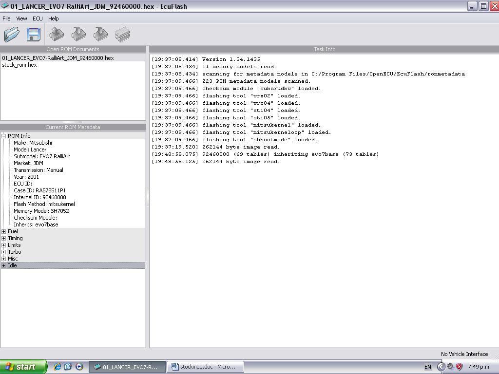

how do you copy and paste using ecu flash.
my ROM info only comes up as (table 1) where as my ralliart ROM has all the maps. how can i paste the ralliart maps when my stock maps arent visble??? HELP

use notepad to open up the closest xml file to your rom. look for the sections of the maps. and copy and paste it into an xml file with your romid. then double check the tables look about right in ecuflash. I am going to do a video tutorial soon, some advanced ones. this may help.
