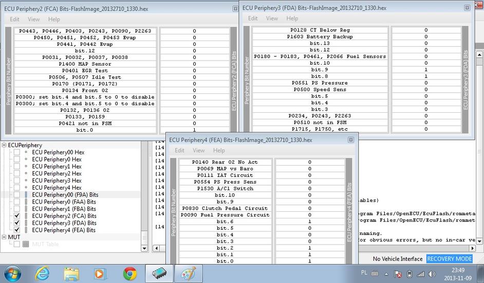

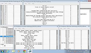

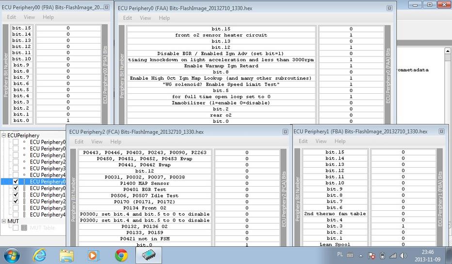

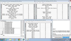

So everything should work. I checked if logging works when the engine is not running and it works ( it shows coolant temperature, throttle position and more) when I start my engine ecu is being disconnected.
I also checked different baud rates with no result.
ECU which I am using is RA560649R1 (evo7) with Tephra v5.01.
I also made screen shots of my pheryphery for your review.
