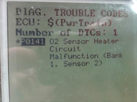

ok i tried the patch and it worked for all but the p0141 o2 sensor heater, which i havent done the resistor mod yet so i was thinking that was gonna happen. Thankks for all the hard work once again.

Turns out that's one of the few tests that it doesn't disable. It also does not disable P0069, P0111, P0554, P1530, P0830, and P0090. These along with P0140 are all controlled by P4_FEA.
