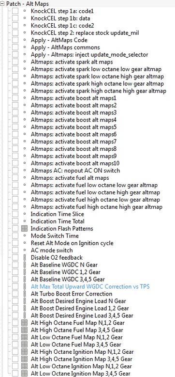

Everything seems to work fine.
Knock CEL patch required.
Switching can be done by:
1) Pressing +/- on the wheel or AT knob
2) AC switch
3) Full Throttle while turning ignition ON (only to alt maps, not back)
Switches fuel, ignition, boost maps and closed loop mode on-the-fly while driving.
Configurable indication using CEL.
Supports current mode saving after turning ignition OFF.
