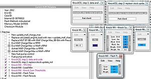

Knock CEL is ready & tested. Works great
could u please explain the benefit from those knock settings?
I do have some knock issues and I am trying to eliminate by puling some timing, but I really interested in some extra infos about knock.
Thank you

This patch makes check engine light blink while knocking.
Oh! ok! nice! When flashes slow it means low knock, and flashing fast is high knock.
Mine does the same now but I have different settings....
great work anyway!
