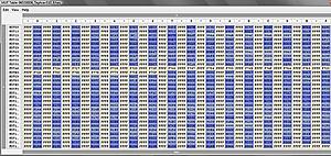

what MUT ID's is your evoscan using for 2byte?
00 and 01
Thanks for your help BTW.
Old May 11, 2009 | 09:14 PM
  #40
tephra's Avatar
Joined: Feb 2007
Posts: 9,486
Likes: 67
From: Melbourne, Australia
ok so MUT00 and MUT01 are 0x898A and 0x898B respectively
this is for 96530006 yeh?
well load raw is 8984/8985
so like I said 898a/b is either temp+baro or temp corrected
