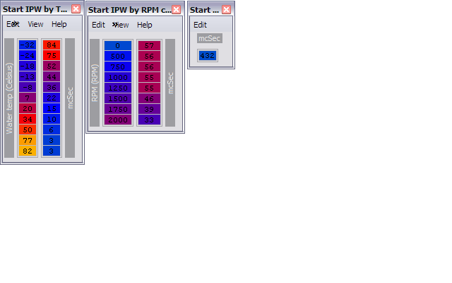

I used "IPW mcsec" on all 3.
The temp table looks like it will have most effect on cold start.

AHA! I hope this is it! comparing Stock for stock values, I'm changing this to match my 14v latency number. I'll report back in the am.
