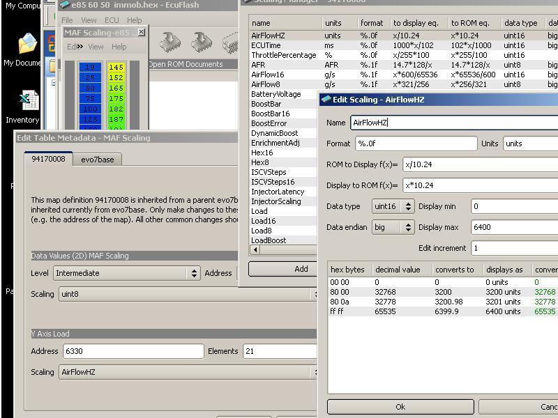

1. Change scaling of the top part (named Data Values (2D) MAF scaling) from "Airflow 8" to "unit8"
2.We need to change the scaling of the bottom part (named Y axis load) as well but first we will need to make a new definition for it. It's real simple.
2a: Click on "Scalings" button, click "Add" button on the bottom. Put something in the name, like "AirFlowHz"
In the "ROM to display f(x)=" line change "x" to "x/10.24"
In the "Display to ROM f(x)=" line change "x" to "x*10.24"
Change "data type" from "unit8" to "unit16"
Change "display max" from "255" to "6400"
Now click ok and exit out of the scaling manager and
2b: Change the scaling of the bottom part (named Y axis load) from "unit16" to the one you just defined and named "AirFlowHz" or whatever you named it.
You're done. Now go fix that idle!!!
Thanks to SophieSleeps and Eric (l2r99gst) for the original post and I hope i didn't mess anything up.

EDIT: So I went to change the scaling and it's coming out completely wrong. I followed each step and went back and did it again just to make sure, but the table came out completely wrong.
The column on the right is the same, but the one on the left is completely jacked. Looks like this:
4800
Any ideas?
4800
Any ideas?
Trending Topics
The only difference in mine is that the column that says "hex bytes" is wrong on mine. Your's is:
00 00
80 00
80 0a
ff ff
Whereas mine says:
00 00
00 80
0a 80
ff ff
Would that be what's throwing it off? Everything else in mine matches yours.
00 00
80 00
80 0a
ff ff
Whereas mine says:
00 00
00 80
0a 80
ff ff
