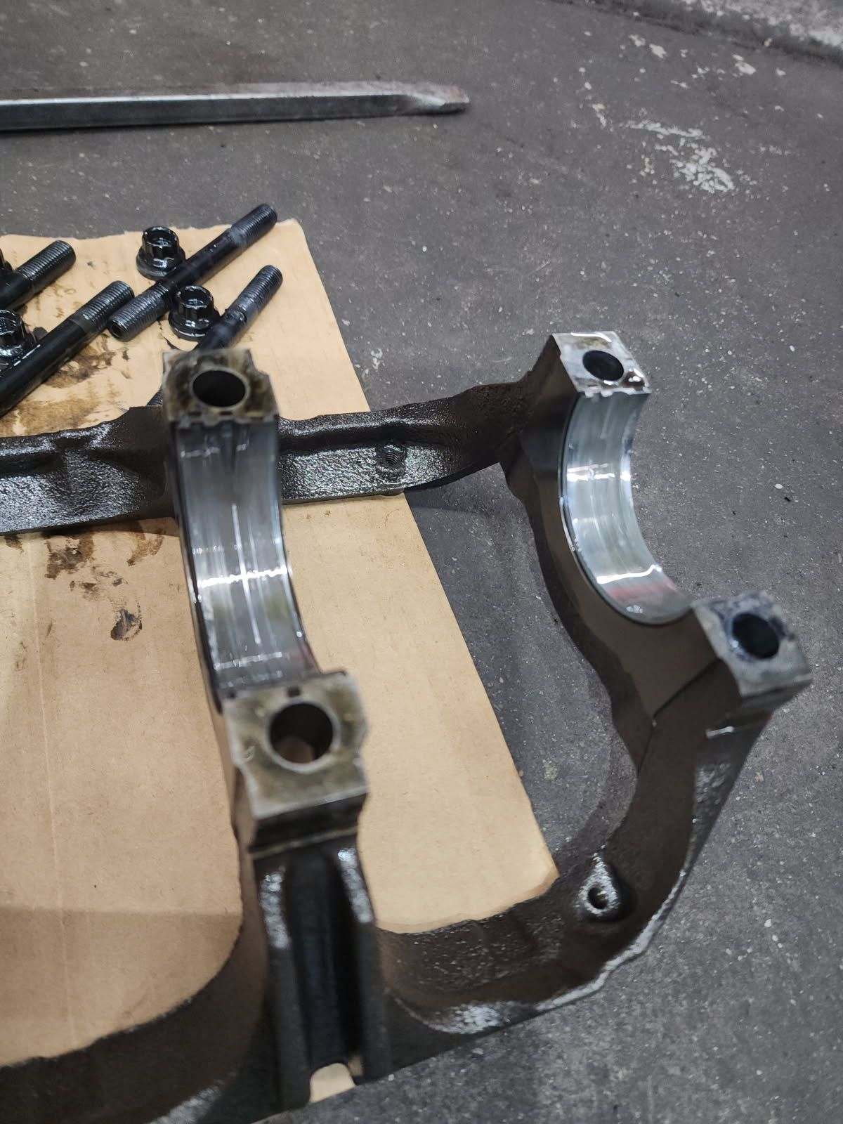

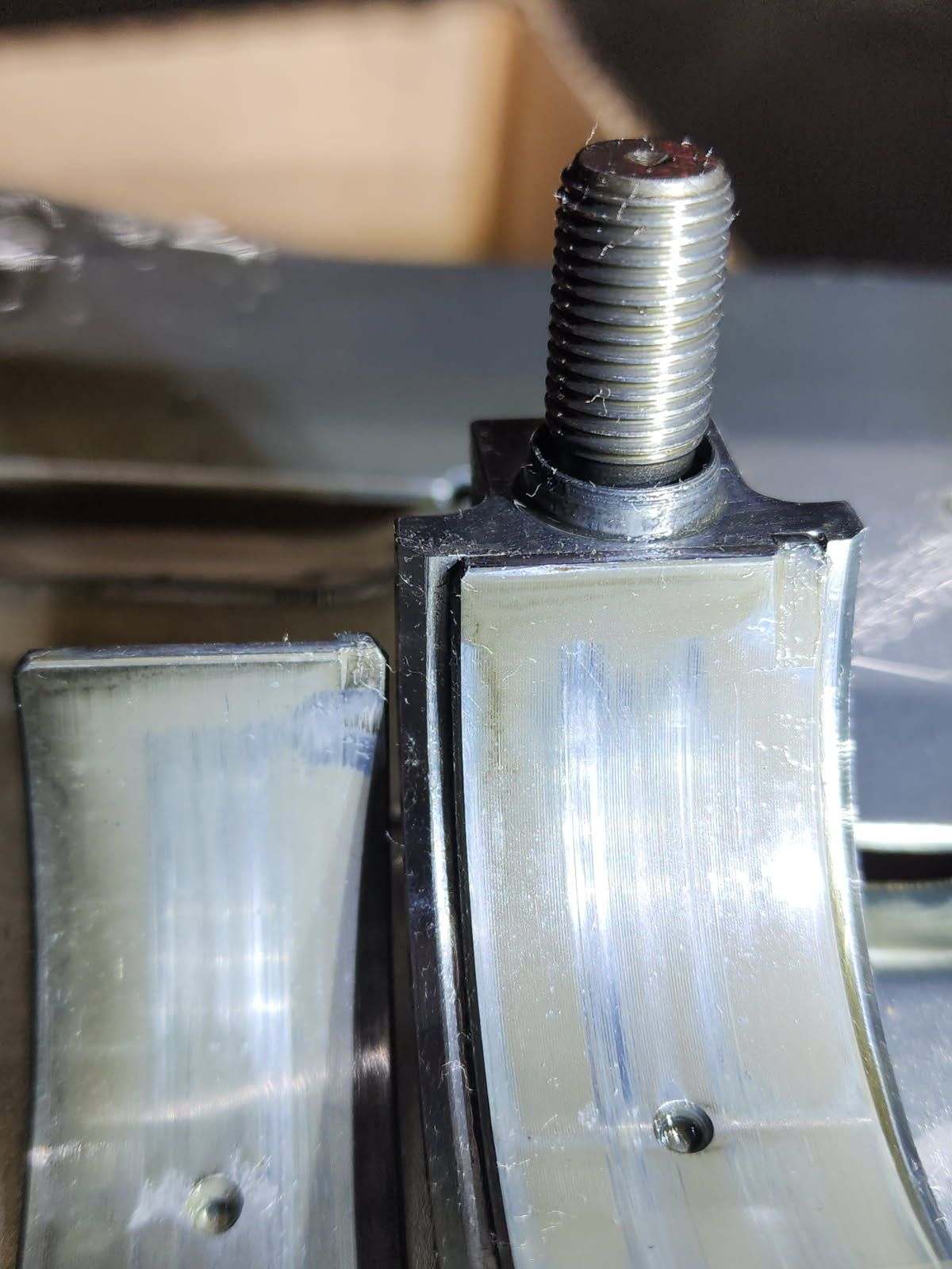

Fast forward to last night he pulls the pan and finds nothing wrong with the rods. In fact this is the worse bearing out of what he found.
So as you see there is isn't really anything to be concerned about. These bearings have about 17k miles on them, no oil squirters in the engine which I found out and I am not happy about being I was told they were putting them in the new motor. So now I hate to do it but main bearings are going to be next. It is odd that I have heard rod knock 10000s of times in all my years of dsms and evos and I was sure that was the noise. So with that says and showing all the bearings and this was the worse out of the 4 I am not sure what the noise was. I thought it may have been the windage tray hitting the rod botls as well but that seems to have plenty of clearance as well so idk what else to think.

I am 100% positive nothing is hitting. The noise I heard got bad after an oil change and the car warmed up. As you see in the pic above, that is the worse bearing out of the 4 rods. The rest of them looked like they had 0 wear on them. But back to the noise, it happened while backing out of the bay. Car ran 5 mins or so to warm up the oil and no noise what so ever. Back it out and rod knock sound as it was backing out of the bay. I have clearance for my exhaust everywhere being along with what you said I figured maybe something is hitting. But this noise is very distinct, and being I have heard plenty of rod knocks in my time I was sure thats what it was and the bearings tell me different. Idk

Yea, thats weird man. The bearing looks fine? I don't know what you could be hearing. It will be interesting to see if the mains look good though I'd expect them to.
Its interesting you have had this the whole time. I'd be doing the same thing you are, making sure there is clearance around the scraper and windage tray, and looking at the bearings.

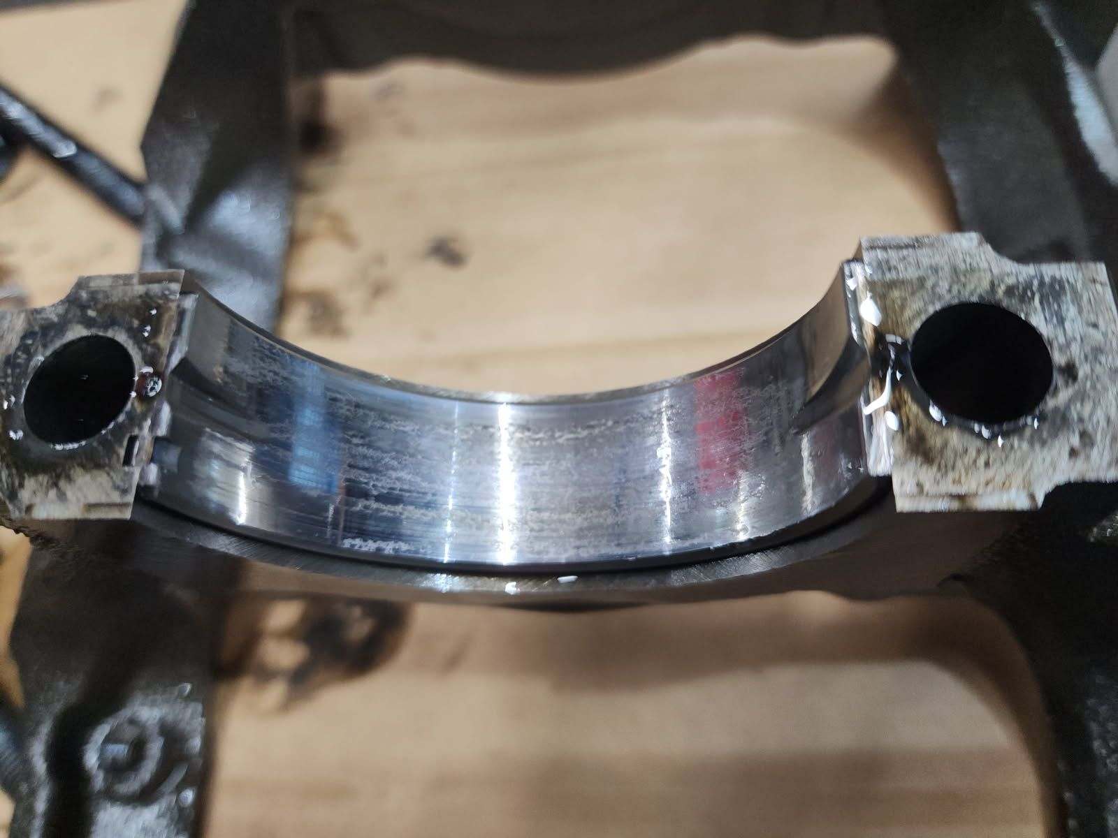

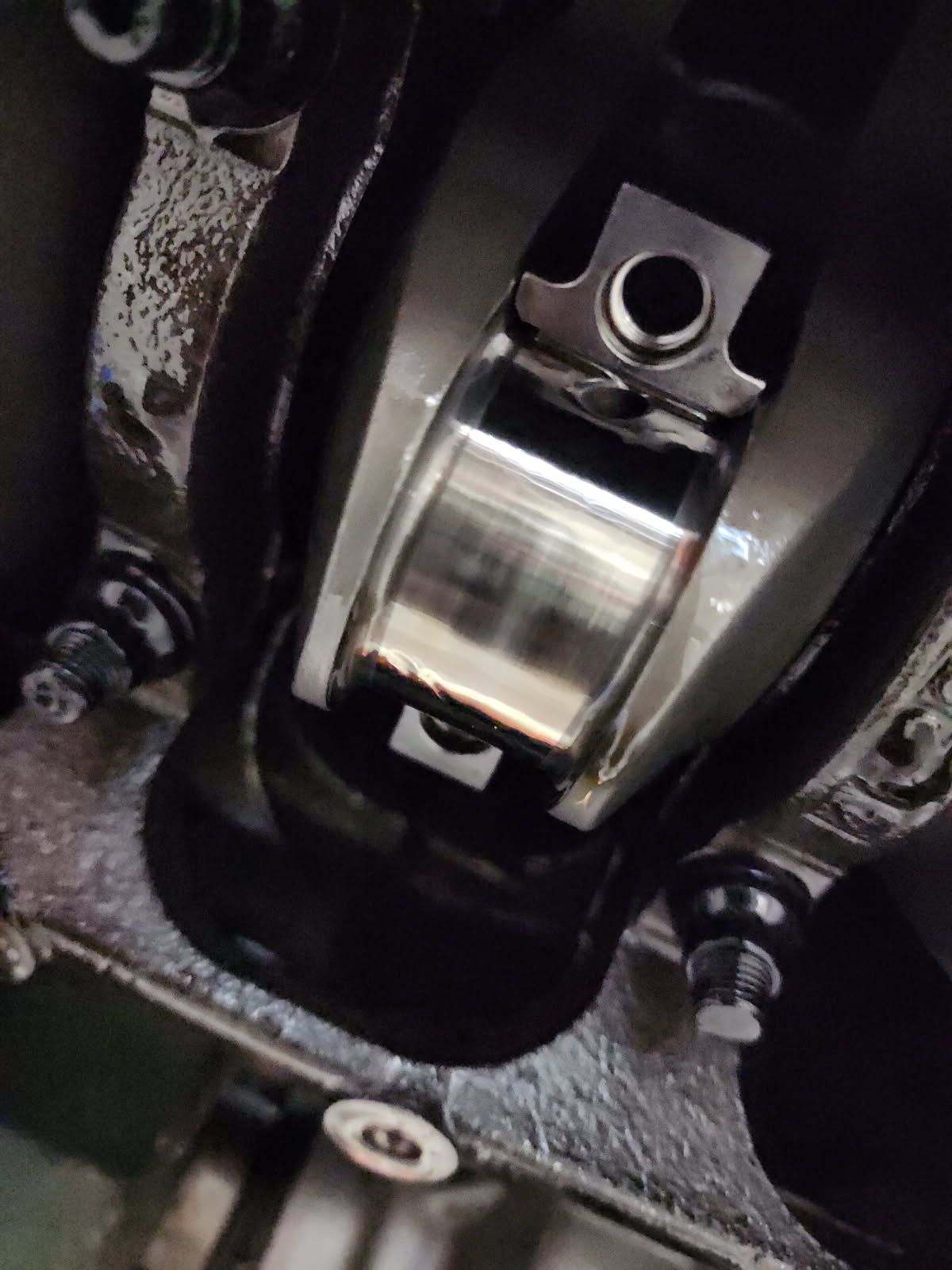

Well after some time and some patience we found out what the noise is.
Now we did find that there was a substance my tuner thinks is moly but im uncertain. I know at one point I put Lucus mystery oil in it to treat noisy lifters. Not saying it was that but could have been. This car saw at least 50 to 60 dyno pulls without a problem with this current oil. Oil was definitely dirty but i don't think moly was the culprit. But I know some of you were wondering what ever happened and here it is.
The odd thing is there is no scoring on the crank and the crank looks brand new still. That is a good thing for me. But the odd thing to me is how did it eat a main bearing before a rod bearing? 15k on the motor I get for maybe some maints done but I didn't think I'd be doing bearings this early.

Wow! That's not good and really interesting. It definitely looks like wear and not like something got run through there to me too.
I'd take the time to re-measure all the main clearances, I wonder if that one was a bit off.
Glad you found the issue and that it seems to be a pretty "simple" fix assuming it all measures out good.
