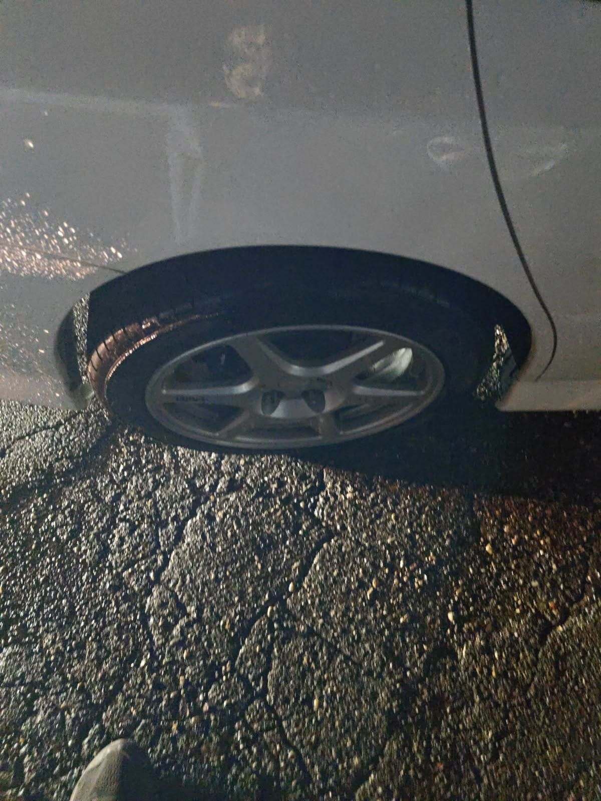

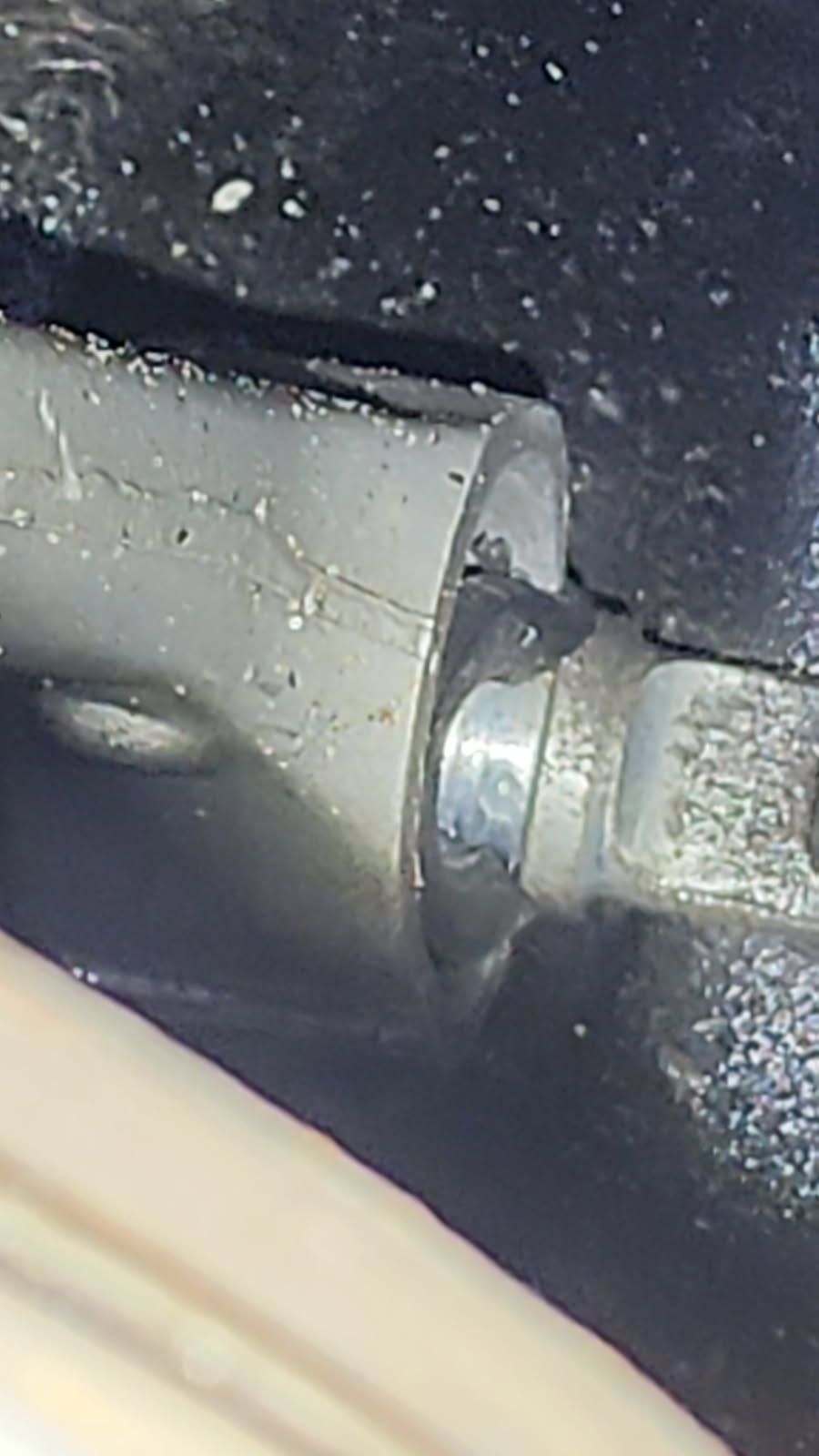

Well I went to pick up my car on Friday. Needless to say I think this car is starting to hate me for whatever reason. So shop it is at, did bushings all round on the car. So my tuner and I took my car to get some food and it was on a bumpy *** road, well long story short we started heading back to the shop and the rear end got really squirrely and heard something hitting something. So I pulled off to the side of the road, pouring rain and my tuner says to me we got a problem. Well no **** right, ends up the new White line rear upper control arm bushing is all tore up, and idk couldn't tell but looks like the control arm is broke. The wheel has a bunch of toe in and the knocking I was hearing was the control arm hitting the wheel weight on the inside of the tire. Limped the car back to the shop being it was like 2 miles at 5 mph. Car is going to be looked at today hopefully but I may need a passenger side rear upper control arm. I have pics of it that I will upload.
