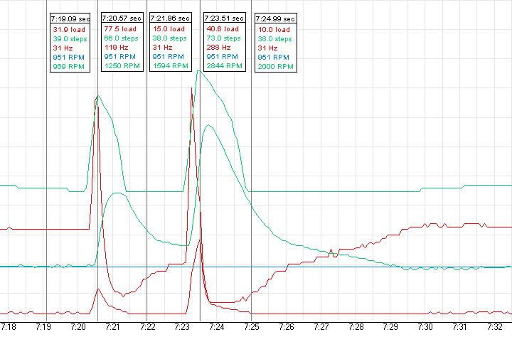

OK, here is a good screenshot of what I am referring to. Actually there are similar screenshots in the thread that redlanevo started entitled 'Buschur intake pipe' here. Redlanevo has the same exact problem as well, but in his case, his ISC wasn't responding like it should, so I think there is something awry there.
Anyway, onto these logs from someone else. This person is having this stalling problem and his logs show the same exact airflow disruption as redlanevo's log did. First I will post a screenshot of my log and an explanation, then I will post two screenshots of his log...two because the log gets too crowded with a lot of items shown.
My log:
This log shows me blipping the throttle a couple of times with the following logged (from top to bottom, if you look at the far left of the log):
ISC steps
load
RPM and target RPM (flat line)
Airflow Hz
The thing to note is the area immediately after the airflow spikes, like the next half of a second. The load dips very low and the Hz has a steep smooth drop back to it's original value. Since basic load is MAF/RPM, you can see my load gradually come back to it's normal idle load before the blips as the RPM approaches the target.
The main area I want to point out is the airflow reading, though, and the resulting load reading because of the airflow. Note the shape of the curve, the instant, steep drop, right after the throttle is released (peak of Hz in the log).

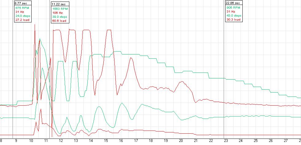

Now, here are the logs from the problem car. Look at the same area that I described above in my log.:
The first log has:
steps
load
RPM
Hz
The second log has:
AFR
RPM
Timing
Hz
In these logs, it appears the user did two rapid blips of the throttle. Look at the airflow Hz line at the bottom of the logs and compare to mine. Before the throttle blip it's fine, after the blip, it starts to drop like it should, then it just hovers at an artifically high reading for a while and gradually start to come down. It should look like a steep ski jump ramp, like mine. His looks more like a mountain.
Anyway, this is the airflow anomoly that I am referring to. This sets off a chain reaction of stumbling, surging, etc, until the ISC has a chance to settle everything down about 5-10 seconds later.
It is this airflow metering error that causes the load to spike (MAF/RPM) because the Hz aren't dropping to where they should be. Look at the load spike up during the decel whereas mine drops very low down, as it should, then comes back up gradually.
This is the exact area that I am referring to about the MAF clamp above. If we could clamp the Hz, in this case at 31Hz, during the decel, I am certain this problem would be completely solved. If your look at redlanevo's thread, his logs show the exact same phenomenon. And it's this phenomenon that was being discussed years ago on the DSMLink site. I don't know if they ever wrote their code or not to resolve it, since I don't have a DSM anymore.
It is this area that units like the HKS EIDS controls. I'm pretty sure that some of the coders in here can write something to handle this nicely.
Hopefully, this explains more of what I am talking about.
Eric
