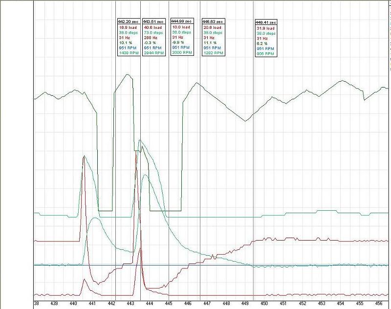

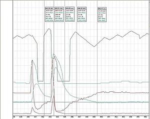

OK, here is a comparison of me blipping my throttle to you blipping your throttle.
A few differences to note:
1. In my log, ISC steps go from 38 to 73, and takes 1.5 seconds to come back to 38 again. The idle then slowly comes back to the target again.
In your log, the ISC doesn't even budge with the throttle blip. It starts at 58 steps and stays there. There is a very brief rise to 69 steps then right back down. But, there is no response to the blip at all, whereas mine follows the throttle blip.
2. My airflow Hz takes about 1.5 seconds to return to normal, which in my log was 31 Hz. It went from 288 Hz to 31 Hz.
Your log takes about 3.6 seconds to return to a normal Hz reading, from 220 Hz back to 57 Hz. During this whole period it is reading way too high. This overrun is causing the load to spike as the RPM dips.
3. After the throttle blip my load reading drops well below the starting point, then works it way back up slowly through a range of about 5 seconds.
Your load drops initially, but the overreading Hz values causing the load to spike back up to where it was when you were blipping the throttle. This load stays there for around 5 seconds before returning to normal.
I won't consider AFR at this point, since I'm not sure if your reading is accurate or not, but it is pretty evident that your MAF is overreading after the throttle blip and causing way too much fuel to be added, as evident by your injector pulsewidth rising, your Hz staying too high, your ISC not increasing, and your load spiking.
My log:
Your log:
I think if we could get your ISC to respond, we may be able to fix this, even with the MAF overreading.
Eric
