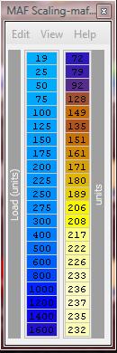

OK, redlanevo, I took a look at your logs and your idle is pretty well tuned with what you have at your 50Hz mark in your maf scaling table. It's your cruise portions that are still anywhere from 10-16% off or so.
With the limited amount of data that we have, this is what I suggest that you try for your MAF scaling, for the first 12 values:
72
79
92
128
149
135
151
161
171
180
189
206
I left the first three values alone. You already had these corrected by roughly -25%. The 50Hz point is where you are idling at and your LTFT Lo is 0 and your STFT is fluctuatiing above and below 0, which is fine. So, those were left alone.
Then, I looked at your logs and from the limited amount of data, it looks like you need the follow corrections:
100 Hz needs about 10% taken out
125 Hz needs about 16% taken out
150Hz needs about 12% taken out
So, I made those adjustments and then tapered the next four cells down at -10%, -8%, -6%, -4%. The cells from there on shouldn't be necessary to tune since you should be in open loop at that time, unless you are doing a high RPM cruise. So, your WOT tuning will use the open loop fueling tables for tuning. I also used an average value for the 75Hz point in between the correction you had at 50Hz and the correction I made at 100Hz.
Give these settings a shot. Load them in, reset the ECU, then let the car idle and warm up, then go cruise at a set RPM again for a few minutes.
See if anything improves at all in terms of drivability. You can do some logs again to check the LTFT Mid. It should be coming closer to 0 now with the above changes. If stalling and drivability still suffers, we may need to tweak the first couple of cells, but we will have to guess a bit there, since you're idling above that range.
BTW, I changed your logs to LogWorks logs, so that I can easily see them in graphical format. If you have LogWorks, you can view them. I will attach them here.
Eric

Here are the logs I just did.
idle1 is a log of the idle after a few minutes of idling. midtrim changed from -13 to -4.
cruise1 is a log of my cruise. midtrim changed from -4 to -5 than to 0.
cruise2 is just a log of the cruise after midtrim changed to 0.
idle2 is the log of my idle after my cruise.
Then I just have 2 logs of when it stumbles. The first one is coming to a stop and the second one is just when I blip the throttle.
OK, your mid trims are looking a lot better now. Maybe a little more tweaking, but much better.
Now, let me take a look at the stumble logs to see if we can try to fix that.
Eric
