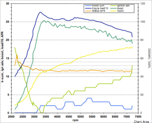

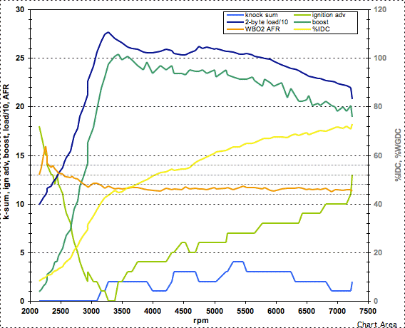

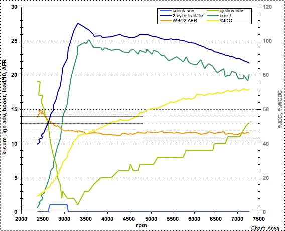

For several months now, I've been noticing that when I do a tuning session, the first pull always has some knock, and then later pulls have less. Has anyone seen also seen this when tuning? Here is an example from this morning. Two pulls back-to-back, same tune.
First:
Second:
Attached Thumbnails always some knock in the first pull when tuning-evoscandatalog_2008.06.24_08.56.58_3rd.gif   always some knock in the first pull when tuning-evoscandatalog_2008.06.24_08.58.08_3rd.gif

can u plot the 2 AFR's together? got any temp stats?
perhaps after the first pull the engine is hotter and thus temps are different thus the ECU is going something slightly different for the the second pull ?
