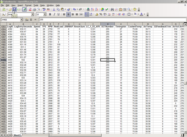

Here's an example of the ridiculous knocks that I'm getting while easing on the throttle during cruising. The octane number doesn't budge but the timing is pulled severely.

yeah well thats the other thing - is 2500rpm/70-100load actually phantom knock or is it real?

https://www.evolutionm.net/forums/sh...d.php?t=349239 ---------------------- Thing is, that knock may be real... you have to think about it's integration with systems like this: https://www.evolutionm.net/forums/sh...&postcount=122
