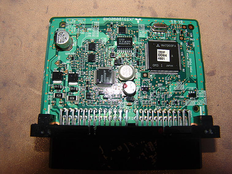

This is the board looks like (at least what i have)
How is (how do you feel it?) the ralliart ecu for the evo ix??? I can read it with no problem, but here in Romania.

I did a quick disassembly of that rom, and something definitely looked "off"; the reset vector referenced an address near the end of the ROM that was actually a long series of 0xFF.
Once I changed the init from 0x14000 to 0x4000, things start looking more like an initialization routine, and all the other vectors matched up to something sane. So, I moved the segment from 0x0 to 0x10000, and references were all correct. Cool, albeit a little odd.
