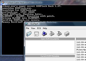

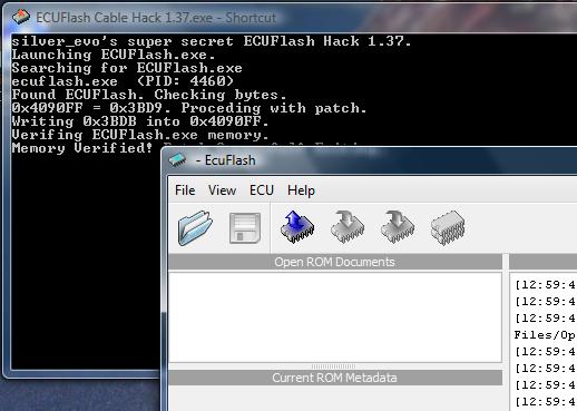

For all of us with the older tactrix cables that dont work with newer versions of ECUFlash i wrote the fix for 1.35. Now that 1.37 is out im thinking about re-writing it as a launcher (so you dont have to open the app seperately). Would anyone be intrested in this?
Update: At the request of like 3 people, i went ahead and made the new version. If your new to this, read here first https://www.evolutionm.net/forums/sh...d.php?t=363025.
This version works the same except you just run the exe file. It launches ecuflash.exe and patches it, then quits. Just drop the exe into your ECUFlash 1.37 folder and run the exe instead of ECUFlash.exe. Replace the ECUflash shortcut with a shortcut to my exe for easy access If anyone wants to know the details here they are:
Code:
004090FF   3BD9             CMP EBX,ECX
was changed to
004090FF   3BDB             CMP EBX,EBX
Same byte as before, just different address. Easy Fix!
Download : https://www.evolutionm.net/forums/at...1&d=1220912326

mrfred talked to colby about the older cable issue. The new version says "make shbootmode less picky about receiving ACK responses" but it still freezes when using an older cable and new software. I think tommorow after work ill get back into it and try another fix.

Updated for 1.38 https://www.evolutionm.net/forums/sh...d.php?t=368672

Dl'ed the 1.38 fix and i get this ????
"silver_evo's super secret ECUFlash Hack 1.38.
Launching ECUFlash.exe.
ECUFlash.exe not found ! Exiting."

Where is the 1.38 hack attempting to launch the ecuflash.exe from (path)???

It launches ecuflash from the current path. So just drop it in your ecuflash folder and run the 1.38 hack exe
