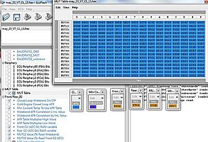

When using the 9653 rom, have you properly setup your MUT table to read the values correctly? Have you setup evoscan correctly? Chances are if you can't get it to work with 9653, your not going to have much luck with another rom. It works and it is very easy.
First things first: Forget the patch. go back to a normal 9653 rom (V7) and get the WB02 working correctly. Follow the threads about this and get evoscan logging your WB02, while the car is running off the front narrow band.
It really sounds like your having issues trying to mod two things at once. Once you get the WB02 logging correctly with 9653, applying the patch is a 5 minuet process, heck not even that long.
and...
Yes you have to enable the patch: see the following pic: the first box to the left under the MUT has a one to enable closed loop WB logging.
Attached Thumbnails how-to: control closed loop AFR with your wideband O2 system-help_pic.jpg
