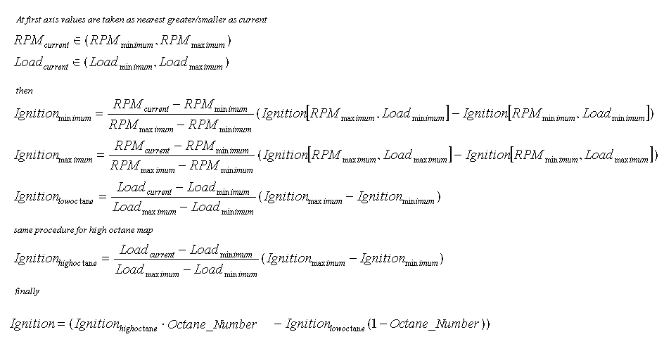

How does the Evo ECUs do ignition advance interpolations?
and fuel map interpolation?
has someone pulled the code to get the calculations?
I found this:
http://en.wikipedia.org/wiki/Bilinear_interpolation
I want to calculate what the ECU Target Timing is at each RPM/LOAD based on interpolation, is there any point? because I think this is what AFRMAP already is? someone correct me if I'm wrong.
is there any target timing advance? or is it what is logged is already the target timing advance based from current rpm/load on the timing map?

The interpolation is the same as for AFR, all 3D maps are interpolated same way, sub_B16 does the job. I have not deciphered the subroutine but it is deciphered by mrfred as
((255-r6)*r5 + r6*r4)/255 -> r0
So it seems, its more of trilinear interpolation, assuming both octane maps are in concern and octane number is a weight factor.
http://en.wikipedia.org/wiki/Trilinear_interpolation
what is logged is already the target timing advance, but some corrections take place after/before interpolation like knock correction, lean spool etc.

((255-r6)*r5 + r6*r4)/255 -> r0 is the routine that does the linear interpolation between high octane and low octane maps. I haven't gone throught the table value interpolation routine yet.

I could not write it in plain text, thus the picture

awesome work acamus, thanks.
