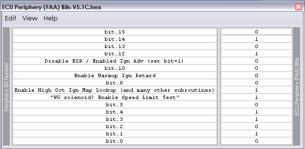

Are you saying (for those of us with blobbits) that "ECU Periphery (FAA) Bits" > Bit 1 is immobilizer? Meaning, setting this to "0" disables it?
its bit 3

Originally Posted by RoadSpike
its bit 3
Thanks man. I've relabled my 94170014 FAA bit 3.
