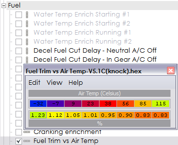

Is the XML for the "Fuel Trim vs Air Temp" table available for 88590015? I am currently stuck using the "Airflow/Hz Baro and Air Temp Compensation" table in Ecuflash because I am unable to locate the correct XML.
Table in question is below:

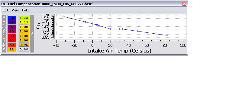

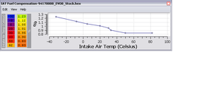

I've seemed to cure my AFR temp change for e85 w/fic1050.
yesterday it was almost 80f, last month it dipped to 32f giving me opportunity to play with it.
The cooler it got the leaner it was
This was stock
Attached Thumbnails Air Temp Compensation table-custom-iat-fuel-comp.png   Air Temp Compensation table-stock-iat-fuel-comp.png
I am also on e85 with the FIC1050s and have had the same exact issue. Thanks for posting your tables!
