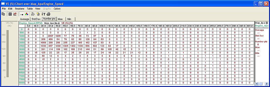

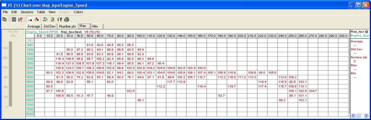

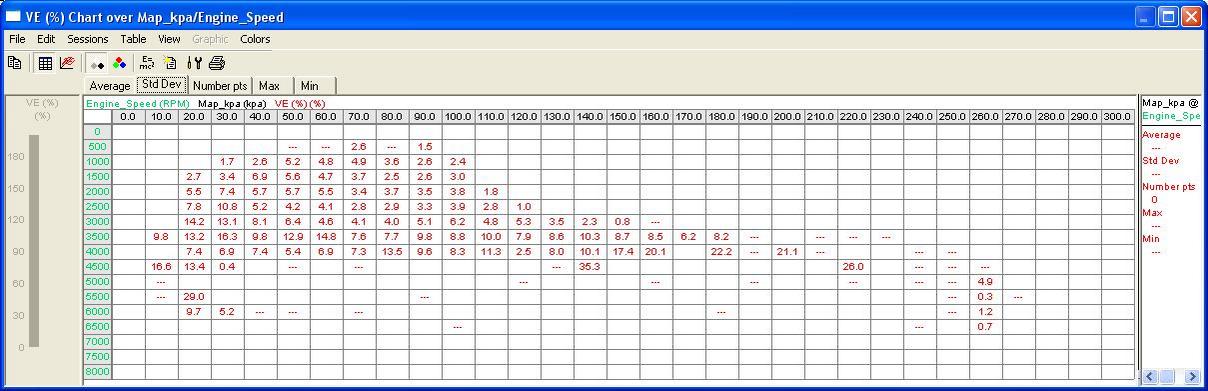

OK, John, here is Tephra's data plotted in LogWorks from his old MAF log. It is map (kpa) vs RPM, with VE (100*load/map) as the data:
Here is the rest of the tabs from the data aboce (standard deviation, number of points, max, min):
Attached Thumbnails SD - first test success-tephra-ve-avg.jpg   SD - first test success-tephra-ve-stddev.jpg   SD - first test success-tephra-ve-numpoints.jpg   SD - first test success-tephra-ve-max.jpg   SD - first test success-tephra-ve-min.jpg

Thanks Eric.
20kPa: 70%
30kPa: 77%
70kPa: 77%
80kPa: 80%
90kPa: 85%
100kPa: 90%
120kPa: 95%
130kPa: 100%
That is 8 bins, but we can do a 10kPa and a 310kPa by coding the above creatively.
We do have to have the top value, otherwise it will just stay at the load in the last bin and would never richen beyond it - so it 130kPa was your last bin you wouldn't go over 130 load!
