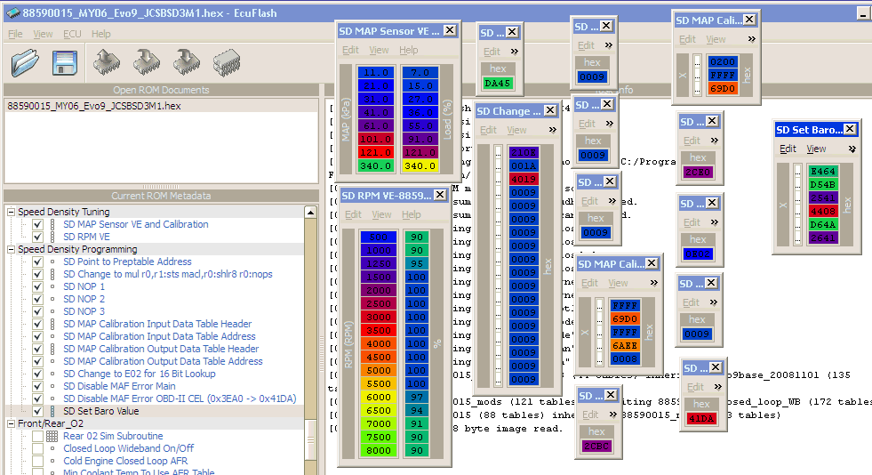

I've just about finished porting jcsbanks SD v3 over to the 88590015 ROM. Its been a fair bit of work because there are some differences in the USDM ROM code that required me to handle the MAF and baro errors differently. I'm putting what I have up now, so people who have a MAT sensor installed can start preparing a ROM.
*I have one remaining item to finish before it can be used.* I still need to create a scaling for the GM MAT sensor that can be inserted into the IAT sensor scaling table so that I can switch the IAT values over to MAT values.
*NOTE* Once the port is complete (hopefully by Wednesday afternoon), it will only work in conjunction with my MAT logging patch (along with a GM IAT sensor installed somewhere along the intake track).
EDIT #1: Duh, I forgot to mention that the car needs to have my JDM MAP sensor patch + JDM MAP sensor installed.
EDIT #2: jcsb, just in case you are wondering, the NOP1 erases the move #1, r2 that tephra mentioned.
Patched ROM and xml are here (copy the tables from the patched ROM to your ROM):
http://se30.dyndns.org:8080/EVO/8859..._JCSBSD3M1.zip
ECUFlash screen shot:
I have Rom ID# 88590015 as well. So basically all I need is a GM IAT sensor and the JDM MAP sensor along with this patch and SD is all ready to go?
