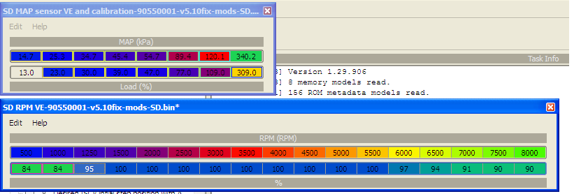

mrfred, no it is the same as SD3.
03whitegsr, sounds a good method. Another table would add more complexity to the programming. To change map sensor: copy the axis of the table to the clipboard, edit the axis scaling to suit your new sensor, paste the old axis values again. The map calibration can then be forgotten forever. If you have multiple MAP sensors for the same ROM then you're a tuner and you're cute enough to cope?

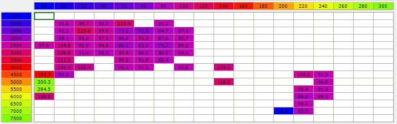

Count shows the number of times cossie1 hit each zone in this log. Average shows Load/MAP as a percentage. The load scaling is actually MAP(kPa) as this is our input to our VE tables, and load is the output.
The present Evoscan map tracer load and RPM zones are not centred so 30 load and 2500 RPM is really 30-39.9 load and 2500-2999 RPM, whereas in the ECU our tables are centred.
So from this log we can see that we need a bigger log with more VE zones hit, but we can still try to sculpture our VE tables from what we can see.
We can for any cell with big counts choose to display average RPM and load, and from that take a note of the % VE we need. Be careful if you look at a 10 load and 500 RPM, all the info may be from 19 load and 975 RPM.
A few from the 2000 RPM area which is commonly used and important to get right... in this log we have good counts (a good number of samples) from 20 to 80 load (I have rounded a bit):
25 kPa (displayed as 20) 93% of 25 is 23
35 kPa (displayed as 30) 87% of 35 is 30
45 kPa (displayed as 40) 87% of 45 is 39
55 kPa (displayed as 50) 85% of 55 is 47
70 kPa (displayed as 60) 85% of 70 is 60
90 kPa (displayed as 80) 85% of 90 is 77
So if this log is representative (I would do another with more samples), I would make MAP bins at 15,25,35,45,55,90,120,340 kPa and put the load in the second for row for each of these at 13,23,30,39,47,77, and I'd work out the 120 and 340 kPa sections from suitable logs as below. I'd set the RPM VE at 2000 to 100%.
Now onto idle, the important cell is 40kPa and 500 RPM. Average RPM in this cell for this log is actually 909 RPM, average MAP is 47kPa, bit higher than mine idles at, but they vary. So really we want to adjust our 45kPa and 1000 RPM cell to get the idle right - to give 73% overall. For 2000 RPM we set 45kPa to 87%, so we need RPM VE at 1000 RPM (and probably 500 RPM) to be 100/87*73=84%.
I only have a snippet of full throttle from cossie1, but it is displayed as WOT. From this I would say the 120 and 340 bins should be set to 91% - ie 109 and 309 giving a final table for cossie1 (although it could be better with bigger logs):
13,23,30,39,47,77,109,309 load
You need the pressures at the extremes of what the sensor is ever likely to see on your engine, otherwise it wll go flat beyond the ends of your table!
Sounds complex, but I did this once and the car drove very well, I revised the idle based on actual STFT and have left the VE table at that since with no issues.
If you've been spoilt by MAF sensors all this may seem complex, but on an SD ECU you either have to complete a good VE chart for every engine, or some VE tables, or just go through every cell and set an IPW. It can be laborious. I found setting up the VE on mine easier than mapping every cell on a MoTeC, and the result is just as good, with much better starting and idle control than the MoTeC.
Suggestion for cossie1 attached.
It will be up to 9% leaner than before which may be too much as I only based it on the single decent full throttle run I had from your logs. It now may well go too lean at the top with baro still plugged in.
