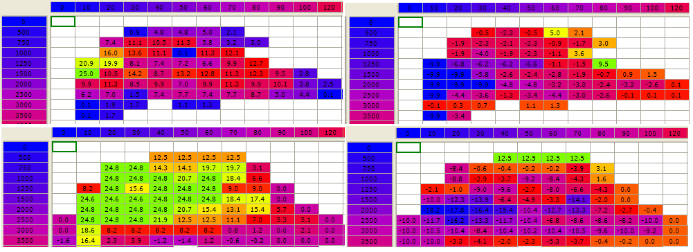

Here is my SD log showing average STFT and Tephra's MAF log showing average STFT.
The reason I show his rather than mine is not to be oppositional, but because I simply never used to collect STFT in my logs!
Both have some surprising outliers - this is completely normal. Overall though, it shows you can get your STFT just as good as MAF - if not better in this example?

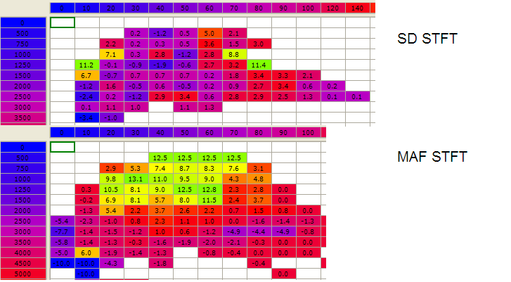

On the top, SD, on the bottom MAF. On the left, max STFT, on the right min STFT.
