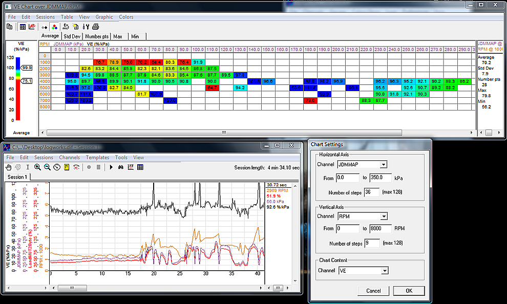

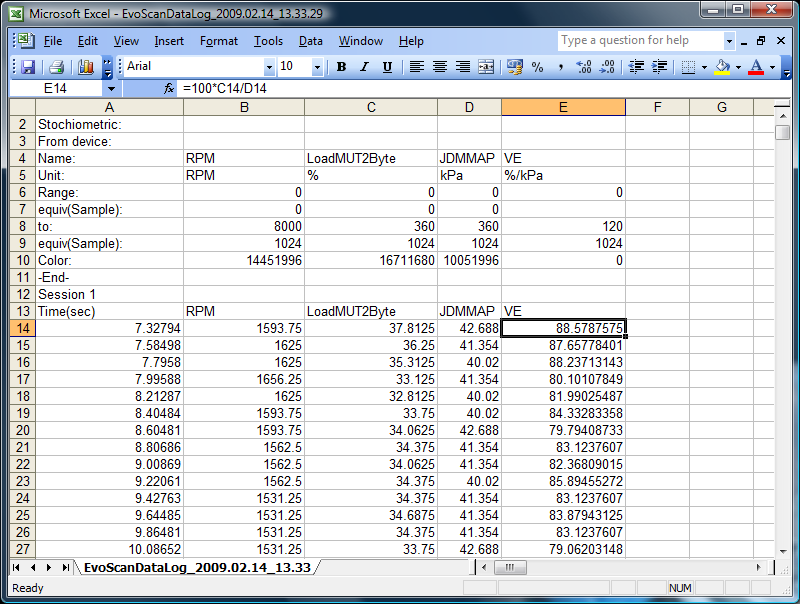

I downloaded logworks 3 even though I have no Innovate products. You can take an Evoscan csv log and play with it in Excel to add the logworks config stuff to the top rows, then save it in .dif and load into logworks. I will post some screenshots in the next post from another computer...

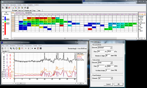

Two images show the preparation of the Evoscan log file (Time heading changed, VE column calculated, logworks heading info inserted) and the table setup for the VE map display.
Attached Thumbnails SD - first test success-logworksprep.png   SD - first test success-tablesetup.png
