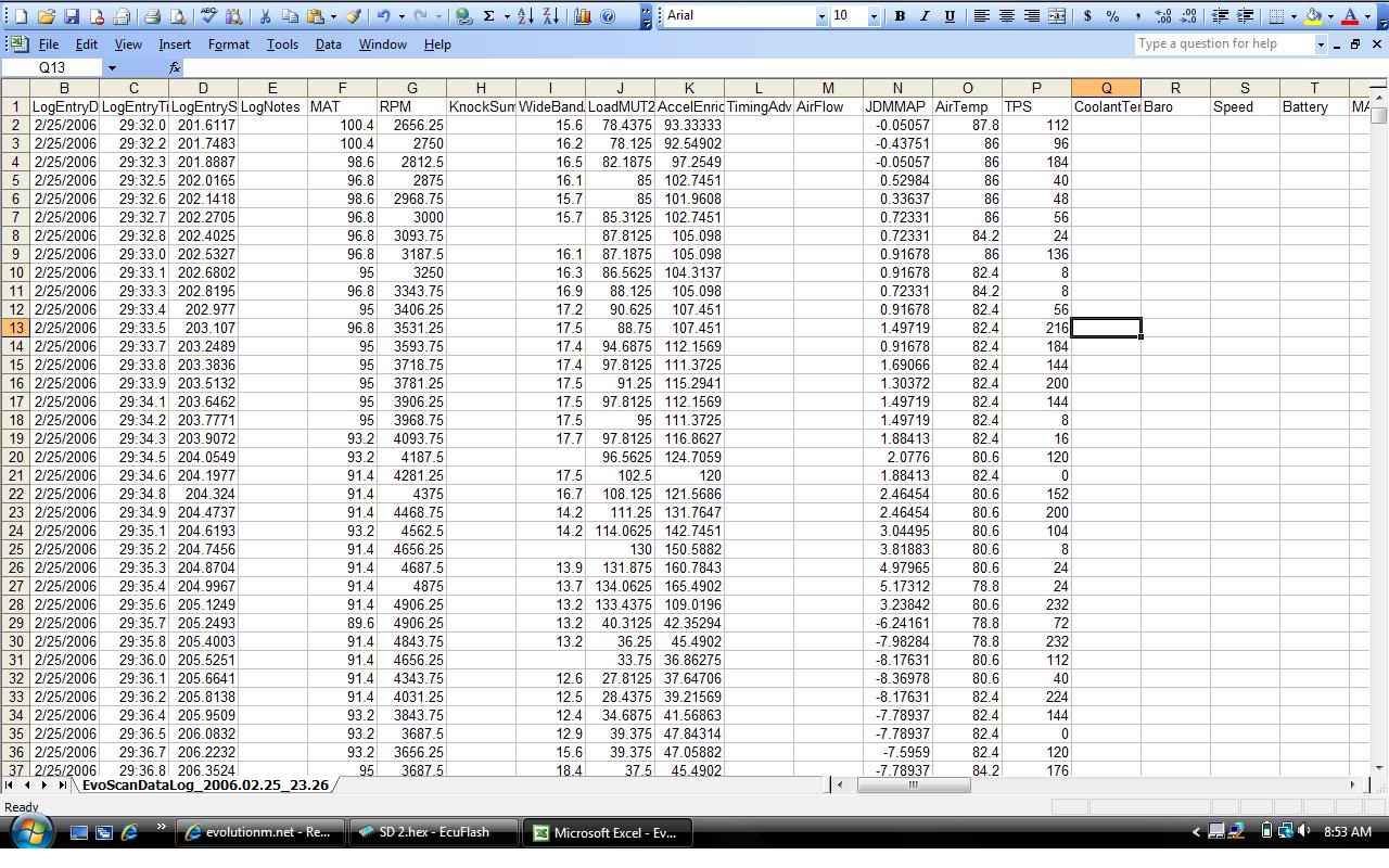

Here is a pic of a log of when I try to hit boost and what it does.

Your load certainly seems to be going up with boost. TPS looks wrong.
It may well be that it will go rich when you go properly open loop, I think here you were probably on the edge if not still in closed loop, your bottom row of the MAP VE table at 90 and 130 load may need to increase. I can see why you wouldn't want to push through a lean area if you think it will just go leaner coming onto boost. Perhaps you could state what load you're going to need at 200kPa (1 bar of boost or 14.5PSI) and also the load you usually hit in the midrange so that you can fill out the VE tables if you haven't already done so.
Can you attach a log from your MAF sensor which includes at least 2 byte load, RPM and MAP? I don't want to make the US turn metric, but it works much nicer if you display MAP in kPa and absolute pressure since at least on stock turbos they're near to 1:1.
I wonder what could be wrong with my TPS? Car has been in a box and now running again, new motor, turbo kit ect. ect.
Thats what I think too, as far as switching to open loop. I do know I would hit 379load at 17 psi with the MAF maxed out. Would playing with when open loop switches make any difference?
I dont have any logs with the map on running MAF but I will get some if you would like...

Are you logging with the baudrate in evoscan set to 62500 but the baudrate in your rom at the stock 15625, as i've had similar tps readings when doing that.
Old Feb 26, 2009 | 09:18 AM
  #431
esevo's Avatar
Posts: 759
From: Tucson AZ
Thanks, I do have it at the stock 15625...
