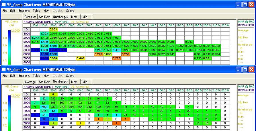

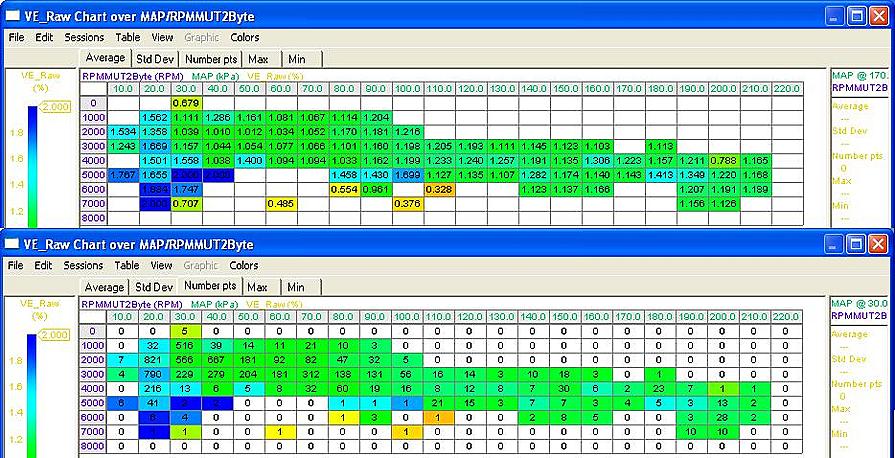

Alright, tried out a few different address to try and find the compensated 2-Byte load. I can't remember the address off the top of my head, but it's 1 word higher then the normal 2-Byte load, just like it is on some of the other ROMs (for 94170015 I think Raw is 895C/5D, Baro Comp is 8960/61, and Baro+IAT is 8962/63). Tephra's 1-Byte load is the Raw load.
I did some more logging and calcs using the compensated load. Below is a comparison of the VE based on Raw load and the VE based on compensated load. L2r99GST, I think this explains why I was seeing VE of 100% on DSMLink fakeMAF that I mentioned in some of the other threads on here. Damn altitude guys...
VE BASED ON RAW LOAD
VE BASED ON COMPENSATED LOAD
Once I get the GM IAT sensor hooked up, I think I'll go get some RPM and LOAD sweeps. This was just a log of driving home while trying to hit a lot of different load sites. I was logging 4 different load channels too so the sample rate wasn't that great.

Using Baro+IAT Compensated load produces a map with much more stable VE values. Mater of fact, with relation to MAP my VE using Baro-IAT compensated load is 0.85 across MAP values between 10kPa and150kPa. I do get some MAP based drop off at higher MAP values, as it drops to 0.81 by 210kPa.
MAP VE
10kPa to 150kPa - 0.85
160kPa - 0.84
170kPa - 0.84
180kPa - 0.84
190kPa - 0.83
200kPa - 0.82
210kPa - 0.81
RPM VE:
0 - 0.80
500 - 0.95
1000 - 0.98
2000 - 0.99
3000 - 0.99
4000 - 1.00
5000 - 1.00
6000 - 0.98
7000 - 0.88
8000 - 0.80
I'd turn up the boost, but I have a stock cat on the car still and the clutch slips anyway. I think I'll do some WOT runs with the boost turned down to wastegate pressure then step it back up in small increments to where it is now.
