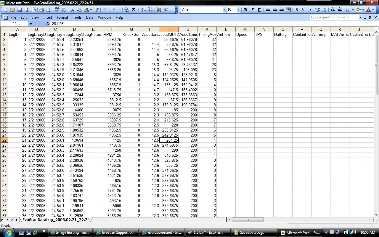

Thanks Ill give that a try!
Originally Posted by jcsbanks
If you're hitting 380 load with only 17 PSI (217kPa) (do you really mean only 17 PSI as whilst the big turbos are efficient it doesn't sound right to me) then you'll need a wildly different VE table to the stock turbo guys, so the MAF based log of mixed driving including full throttle, cruise, idle, will be essential to setup your VE.
If so Ill reinstall the MAF and drive around today logging.
Here is a pic of a MAF log at 17 psi

So how do you tune it when you run more than 17 PSI? Doesn't it just go lean as it is? Have you got the airflow meter mounted near a bend or in a small pipe? I thought Mellon was running more like double that boost to hit 380 load with a pretty big turbo. What do your injector size and fuel map look like?
Anyway, it doesn't matter terribly, you just need to emulate what load you have on the MAF using your VE tables. However, if it was mine I would probably still set it to be 1:1 load:MAP on full midrange boost and then map the rest to suit. So then to have 380 load you would have 380kPa or 40.6 PSI. You can choose how you want to do it, but it is clear why you're running lean given the very high loads you hit with low MAP values.
Forgot to mention, if this is not a 2.0 that is another reason why the load and the MAP are so far apart. You're in uncharted territory, it can still be made to work, just needs some planning and thought.

It goes richer at 380 load with the MAF. I have 1000cc injectors. I am running a 18in metal pipe that is s shaped like the stock one.
I have switched it to KPA/MAP. I will go do three logs with the MAF in; Idle, cruise, and wot. Then post a zip to my Rom, and logs for you to view.

We/you need to decide whether to emulate your MAF arrangement then, which clips/saturates, which obviously isn't ideal, or whether you want to redo your fuel/timing/injector size to suit a new arrangement that is 1:1 for load:MAP at midrange WOT.
I would go for the latter, probably turn lean spool off completely, and fill my fuel map with the actual AFRs I wanted to hit, adjusting the injector size to make it hit that midrange WOT AFR with 100% VE in the tables. Then adjust the RPM VE to get the top end AFR correct. Adjust the MAP & RPM VE to get idle and cruise trims good, and then get your ignition map back on track.
