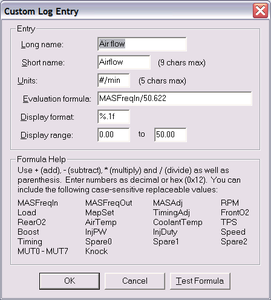

Yeah, unfortunately I don't have time for real world testing. I've taken the car out of street commission so taking it out for a little road tune isn't an option any more. I've got too many other things I'll be testing this week at the track so I just can't log all the MUTs, much less take the time to learn how. (I log with ecu+ so I always have to figure out how you guys do it then translate that over to my software)

Logging custom mut ids isn't possible with ecu+, mybe you ask tom for an update

On the contrary:
You can do this with MUT inputs too.
However, that doesn't mean I can figure out how to do any of this faster.
I'll wait to see what you come up with. As it stands right now my AC fan comes on every time my puller fan comes on. That will work for now, but I'd like to experiment with having it come on all the time.
