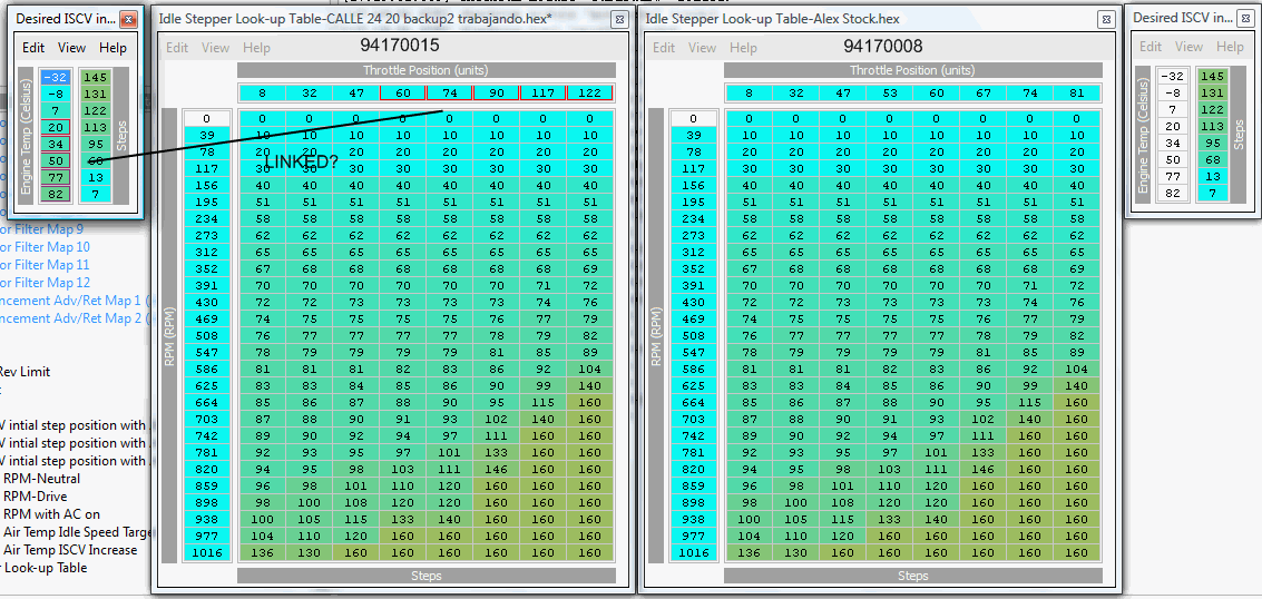

Since changing from my stock 94170008 ROM to the "updated" 94170015 I´ve been having strange idle issues and a "stalling tendency" specially with the A/C ON. I´ve done the usual stuff (boost leak test, etc) to no avail, I decided it was probably normal. However, a couple a days ago we did the ROM change to another STOCK Evo 8 and it started with exactly the same symptoms. I decided to take a look at every table in the ROMS looking for differences and this came up:
The Iddle stepper look-up table is somehow linked to the "Desired ISCV" and "Desired Idle" tables, and this cannot be set to the stock 94170008 ROM Parameters.
You cannot modify the "Engine temp" values in them without modifying the "Throttle position" on the Look-Up table. This DOES NOT happen with the 94170008 ROM, as you can modify them without any effect over the look up table.
I´ve been unable to replicate the values seen on my stock ROM on these tables, and I believe this is the cause of my idle issues.
I´d REALLY like to keep my 94170015 ROM. Do you guys know any possible solutions? Thanks....

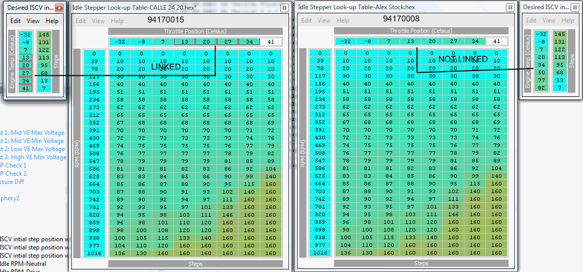

They look different because you have the wrong info. The X-axis is not based on TPS, it is a temperature scale. In 0008 the temp scale address is 6664 and in 0015 it is 68b8. If you have something different then someone has been playing with your scale mapping.
The address matches what you mentioned.
So the real issue is that on 0015:
Idle stepper lookup table, X-Axis Throttle position = 68B8
Desired ISCV, Y Axis Engine temp = 68B8
As you see, it references the same address.
And on 0008, it´s different:
Idle stepper lookup table, X-Axis Throttle position = 6664
Desired ISCV, Y Axis Engine temp = 6630
Could anyone give me the correct address values for 0015?
Thanks a lot.

It's supposed to reference the same address. Temperature scale is the same for a lot of tables, because it isn't really something that should ever be changed. It's just a scale.

After a major rom flash, you should always let the car warmup and leave it to sit and idle for 10 mins, then do the same again with the A/C on. The ecu "learns" an offset for your idle control system and should stabilise itself. If you still have problems, it is time to look elsewhere than the maps first.
Please re-read what I posted earlier. Your X-axis is not TPS, you just need to change the scaling type to Temp and use the addresses I gave you. Your Y-axis address was correct.
They will rarely be the same address. The scale address loacations are at the end of all of the map data, so for each rom there will be differences to the scale addresses depending on the number and size of maps. But, the displayed information should be the same.
Actually, just to confuse everyone, this table has sort-of always been displayed incorrectly by everyone anyway. It is Y that should have 8 elements, not X. There is a header at the top of the map data that gives this. But if you are confused with the addresses, dont try to change this over just yet.

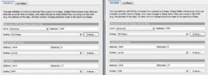

I´ve changed the scale to temp on both roms, it should now be correct. However, the issue of not being able to replicate the stock (0008) values on the new rom (0015) is still there. Do you consider this a non-issue?
